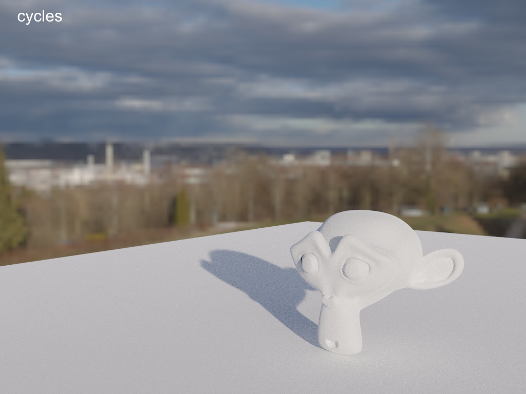

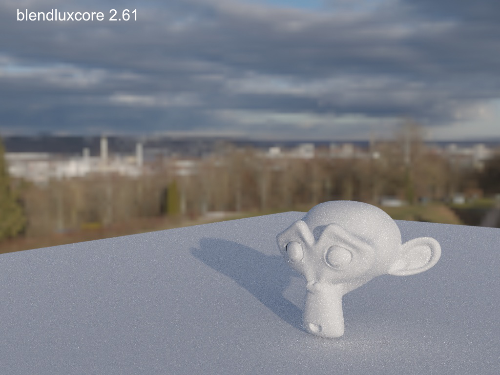

In a simple scene: https://drive.google.com/file/d/1dsdzi2 ... sp=sharing with hdr lighting blendluxcore 2.61(blender 3.0.1) produces much darker result from version 2.5(blender 2.83.19).The 2.5 version produces the same lighting intensity result as cycles does.
I went further and tested other lighting conditions with area light, point light and simple diffuse environment light, in all the tests version 2.61
produced darker results than version 2.5 .
The images below are the results with the hdr lighting. (windows 10, nvidia card)

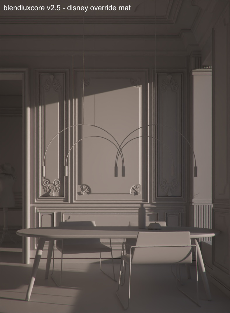

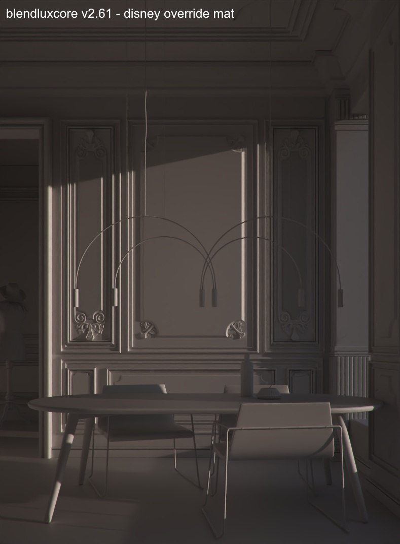

I made another test and it seems disney material behaves differently between blendluxcore versions 2.61 and 2.5, while the glossy material gives the same result to both versions.
The scene is light up with a hdr.
Maybe it is those changes in version 2.6:
Disney glossiness evaluation (for PGI, Albedo AOV, etc.) now checks metal and specular parameters
Disney glossiness evaluation uses now the square root of the value to align with the roughness of Glossy2, Metal, etc.
Fixed a bug in Disney material causing bright edges
