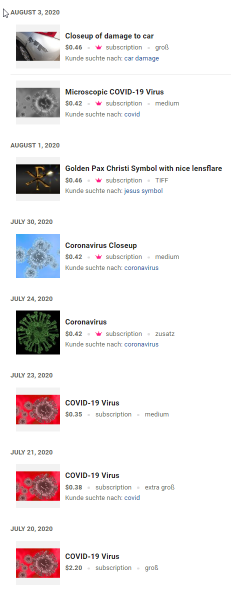

During Corona, the situation changed a bit direction Cycles because i sold quite some Viruses.
For them i needed a Microscope like Material, did not know how this can be done in Luxcore.
Just for fun here are the last pictures I sold. I think the Corona thing is nearly dead.
Because since a few days the Virus sales have stopped ...
Here my last sales in Dreamstime (link in the footer).
