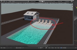

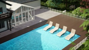

I think that's what you need right? if it is let me know so I can send it to you.
Of course, you will need to add your own light and other stuff, the most problem caused by the ground modeling problem with a few hide segments and also a problem with many undefined light sources. if you need more information let me know so I send you a few tips along with screenshots.

YES!
Although in the zone of the long chairs it's a bit burnt...I would accept this OF COURSE.

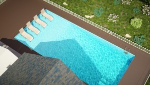

Re: Problems for getting the caustics in a pool
This part needs a little bit more depth or darker color, it's pure white and also too close to the surface.
Also, you need to replace the sky if you want to use Hdri, and you are good to go. I mostly fix the issue with modeling, materials, light sources, etc, the artistic part is all yours. :)
Now the scene is working and of course, you can do whatever you want to it.

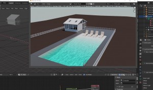

To remind you I detached all the emission nodes for daylight, remember to attach them for nighttime.
give it a little bit of time and it will render perfectly.

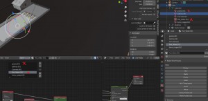

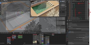

If you want to fix it yourself the most problem was about these two groups and shaders. just delete them you already have water on top of it.
the other part I fixed was for the performance and as you can see the scene that I send to you render much faster. you can compare the scene and fix other issues too.

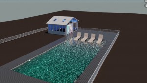

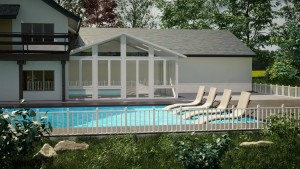

this is another optimization to make rendering faster and with better caustic results.
if you want to render in daylight with bright sun you need to turn off the other small lights as in real life they are not effective and nor visible anyway. (I know you can do that with the light group but as I do not know how I just turn them off directly)
And that's the result for daylight. in just 1 min and 30 sec with a little bit more time, you will get much better results.

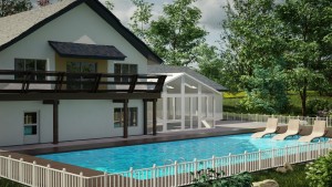

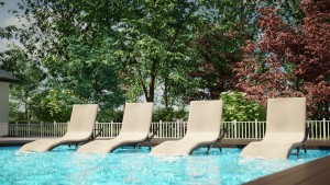

Hi!.
After the great help TAO provided I'm happy to show the final renders.
The walls of the pool must be blue and every emitter or lightsource in the scene caused influence which could distort the final result.
After turning all them off I got these results.
Thank you TAO!
