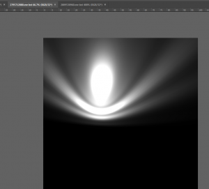

Hi Dade,
thank you for helping me out.
I am almost there. I encountered an issue with commas in my scene.cfg: viewtopic.php?t=330
And solved it by replacing them with nothing in the file.
Now there are basically two issues:
1) The luxcoreui crashes once it tries to bake the third object in my scene (the glass dice)
2) The floor texture which is baked before (it is flipped in x-Dimension currently) does not take into account the glass dice at all, not even as a shadow caster let alone for the nice light tracing effect I want to achieve :|
I attached my Blender scene and the LuxCore output, maybe you can have a look?

Marcurion wrote: Wed Oct 07, 2020 4:25 pm I am almost there. I encountered an issue with commas in my scene.cfg: viewtopic.php?t=330
This should not happen if you are using the under development v2.5, are you ?
Marcurion wrote: Wed Oct 07, 2020 4:25 pm And solved it by replacing them with nothing in the file.
You .ply files a corrupted by "," inside numbers:
format binary_little_endian 1.0
comment Created by LuxRays v2.4
element vertex 9,954
property float x
property float y
property float z
property float nx
property float ny
property float nz
property float s
property float t
element face 18,432
property list uchar uint vertex_indices
end_header
Again, I assume you are using v2.4 :?:
