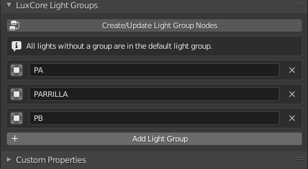

Hello,
I'm new in Luxcore more or less, but I'm interested on start to use it for production.
One super important thing to me is Light groups. The other cryptomatte, a pity we don't have it here.
Regarding light groups, I was trying with version 2,4 and was working great but I had to set the composition manually but was working perfectly on interactive. Now I have installed the beta 2,5 b1 and It's making the compositing nodes perfectly but I have no option to change the interactive.
I'm using official blender release 2,91 from steam.
cheers,
Pato.
This is more or less intended (it's a Blender limitation that the compositor can't be run on a rendered image while rendering is still ongoing).
You will have to wait until the render is done before you can start working with the light groups.

Pato wrote:
Thu Jan 14, 2021 2:57 pm
I got that, what I want to say is that before I was able to turn on and off on interactive mode and now it's not possible.
This is intended. I removed the old light group settings, otherwise the system would have become too unintuitive and convoluted.
