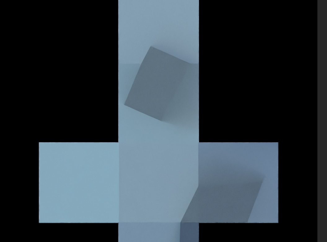

I have added the support for transparencies and shadowcatcher to BAKECPU: https://skfb.ly/6QoxX

I have added the support for denoising baked light maps with Intel ODIN (i.e. the new OIDN v1.1 feature).

Note: BAKECPU is not exposed in BlendLuxCore. This stuff is currently used only by https://www.vectary.com

Dade wrote:
Tue May 05, 2020 12:07 pm
If I use only luxcoreui, should I manually apply "denoise" to baked maps using OIDN (denoise.exe)?
Posts: 4393
Re: A baking test scene
Post by Dade » Sat May 16, 2020 2:30 pm
zuljin3d wrote:
Sat May 16, 2020 1:55 pm
You can define an image pipeline in the .cfg including OIDN, like: https://github.com/LuxCoreRender/LuxCor ... ke.cfg#L39
zuljin3d
Posts: 51
Post by zuljin3d » Sat May 16, 2020 4:41 pm
Thanks a lot Dade, it works!
