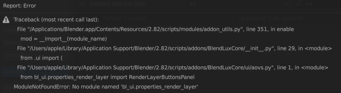

Hi, everyone! I've got some issue trying to install a Blender add-on (see the error report in the attachment). I'm on macOS 10.13.6. The issue persisted through Blender vv. 2.80 - 28.2.

You need to restart Blender after deinstallation of old version. Then install new version
You seem to have a vesion missmatch since the old lib is already laoded.
10.13.6 and Blender up to 2.81a should work without issue.

Thanks, I've done that and it worked with 2.81. The 2.82 now crashes after I mark the check box to activate the add-on.
