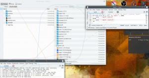

Yes it's the same one that i studied hard:
But to be clear, i need to build luxcore ui standalone opencl.
Am i missing something from below?
Re: Linux Compiling LuxCore
You need the name the the cloned LuxCore repository "LuxCore-opencl" (not "LuxCore") otherwise it will be built without OpenCL support.
