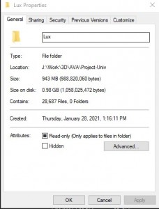

The scene is too huge to be uploaded. around 1 GB.
But I think I can make a sample from a few objects, so, maybe you can help me to better understand instancing proccess.

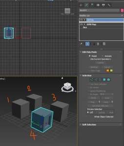

Here is a simple scene to start with.
In this scene, all of these objects are instances from the 3dsmax point of view.
Object 2 is an instance from object 1 and they are identical.
Object 3 is a copy of object 2, exactly the same plus on top of that add a UV modifier to change the UV scale.
Object 4 is an instance of object 1 plus mesh modifier on top of it. (reference object)
if object one change all other objects will change, if any modifier change on object 3 and 4 will not affect the other objects. Are these objects considering instance at all?

As I wrote elsewhere, you need to use the DuplicateObject method to create a large number of instances, it is the correct way to create them.
You need also to detect instances to save memory: otherwise you are duplicating the meshes and using an insane amount of memory.
The scene you posted created 4 different meshes while 1 and 2 should share the same mesh (not the others).

Thank you for the point. as I can see instance objects should be exactly the same and in my scene, there is about 26000 instance object that can speed up the project with instancing.
Still, I have a hard time using it in the correct way.
