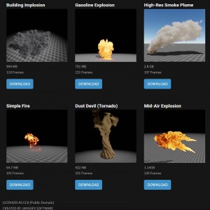

FREE VDB SIMULATIONS CREATED WITH EMBERGEN
Posted: Fri Mar 06, 2020 10:05 pm
by kintuX
We have generated numerous volumetric simulations with EmberGen and exported them as VDBs for you to use in your own projects (Blender, Houdini, Octane, Arnold, etc). These free VDB simulations are licensed as CC0 (Public Domain) so you are free to use them however you want! You can view our available free VDBs down below, and we hope that they give you a taste of how powerful EmberGen really is! EmberGen is our real-time volumetric simulation tool and it allows you to create volumetric simulations within seconds instead of hours or days.
LICENSED AS CC0 (Public Domain)
CREATED BY JANGAFX SOFTWARE
https://jangafx.com/software/embergen/d ... nimations/
