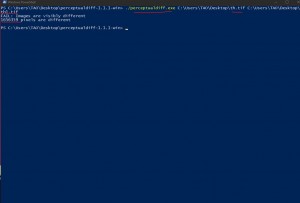

Hi.

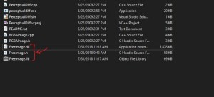

I try that and It works fine, you just need to download freeimage library (x86) and put it in the source directory, also remember to type the full path of your image.

Thanks TAO
Linking to the pre-built FreeImage DLL works for me too.
I wonder why it has problems with the static version of the library that we have in WindowsCompileDeps: it builds fine, but then gives errors when reading image files.
Not a big problem anyway, since it's working with the DLL.

nice.
yeah, they should add dependencies library with it as they re all open source and free to use.
about not reading the image file as I mention that before you should input full path, not just image name.
