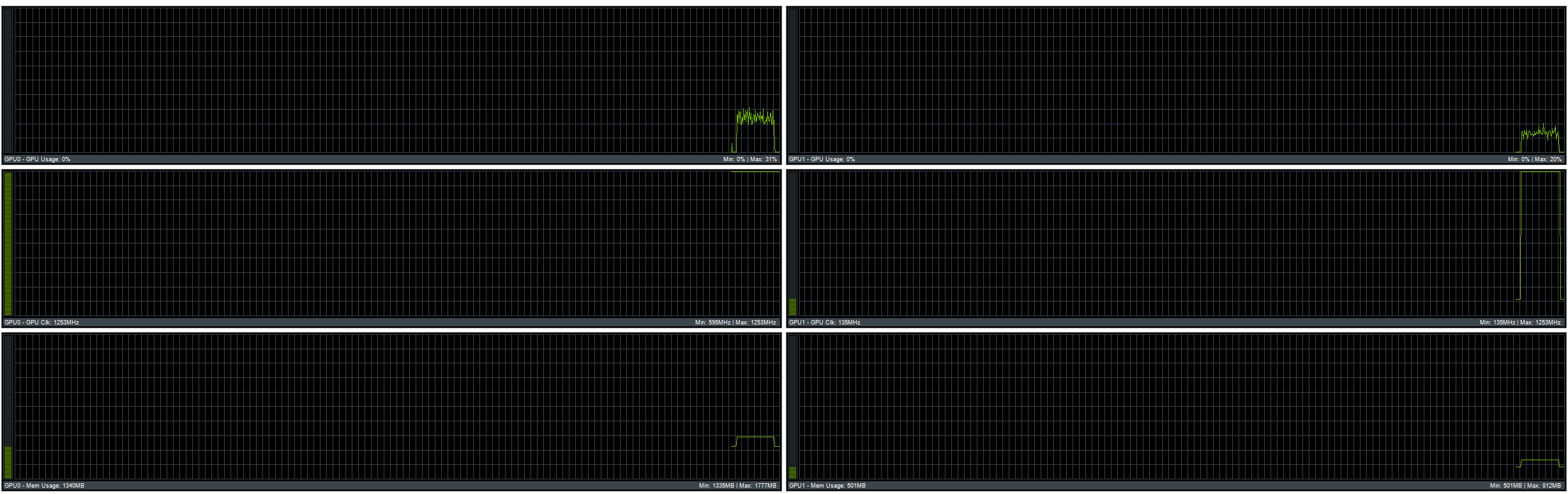

sure thing , i checked the NVIDIA Inspector, it can save only csv file , is this a helpful format for you ?
or do you need an image chart ?

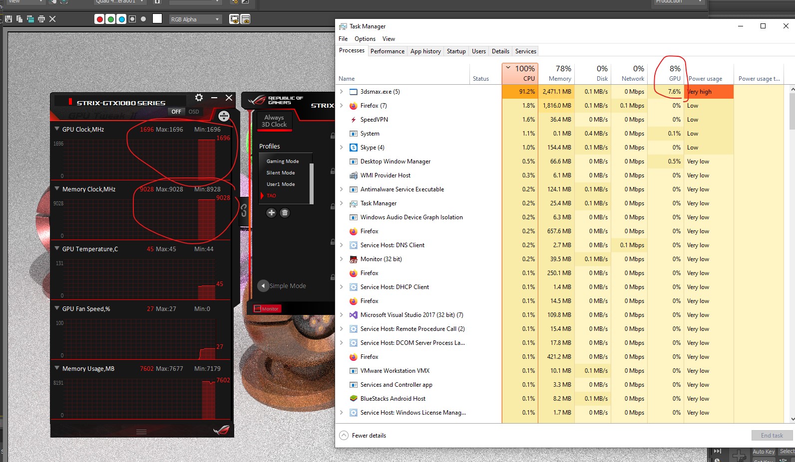

The GPU usage in task manager show different usage than the GPU tweak on my pc

yeah , that's why i don't rely on the Task Manager charts as the are always not correct, that's why i use NVIDIA Inspector.TAO wrote: Sun May 17, 2020 12:12 pm Anything should be okay.

1 GPU: 2 GPUs:

As i noticed , you are looking in the GPU Tweak at the "GPU Clock", this is not what you are supposed to look at , look for something like "GPU Usage".TAO wrote: Sun May 17, 2020 12:12 pm Anything should be okay.
your GPU clock could be at full Clock Hz, but your GPU usage is 0 .

I can confirm TILEPATHOCL is slower than PATHOCL and it just uses less than 20% of GPU.
I will investigate to see if the issue has come from MaxToLux or LuxCore itself.

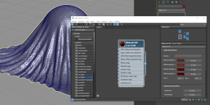

Improvement of Cloth material integration.
