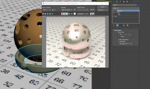

Ok, on max 2021 the scene converter files are in the max root not in enu. And as I see the scene converter doesn't show the script extension nor the root where they are saved, when you save new presets or whatever. There are little differences in max 2021.
Now that I've found them. I'll try to copy the existing scripts and edit them manually. will try to make them work. no promises, I'm a noob.

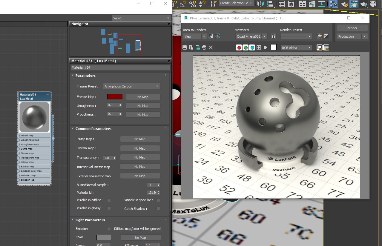

Fix the issue with the metal preset not affect correctly.

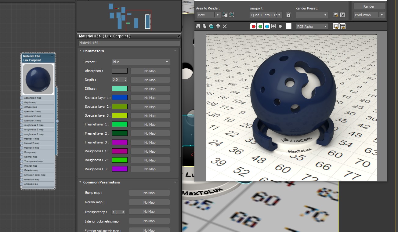

Fix the carpaint material preset not working as it suppose to.

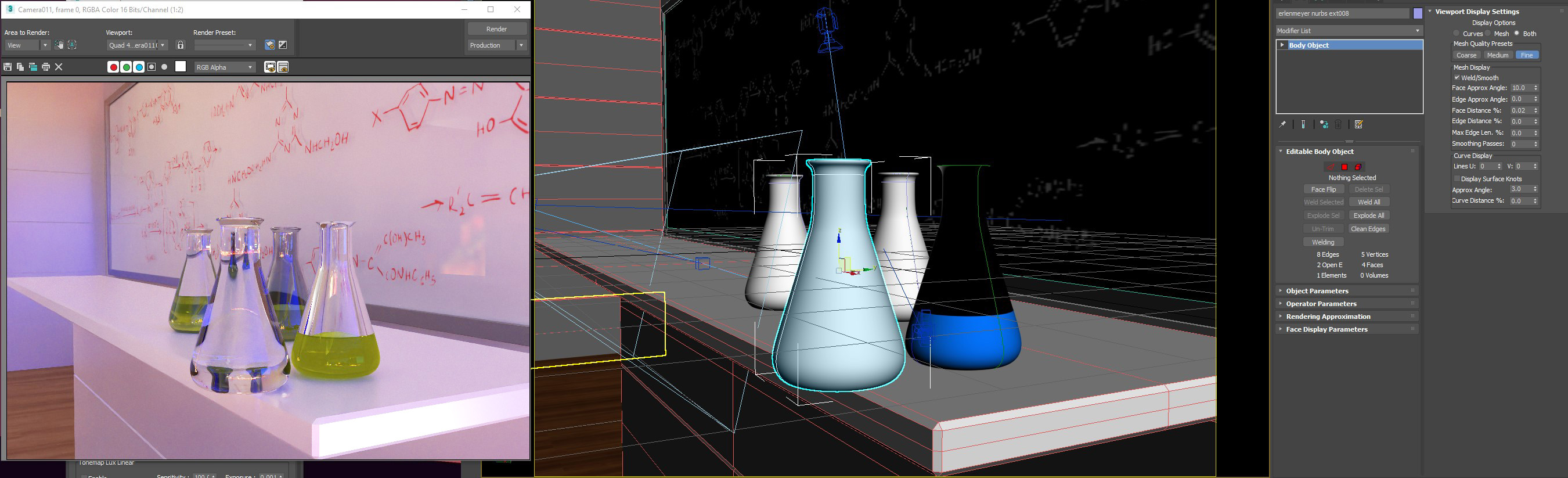

Add support for Body Objects, no need for UV map / Normal correction for dynamic material like glass anymore.

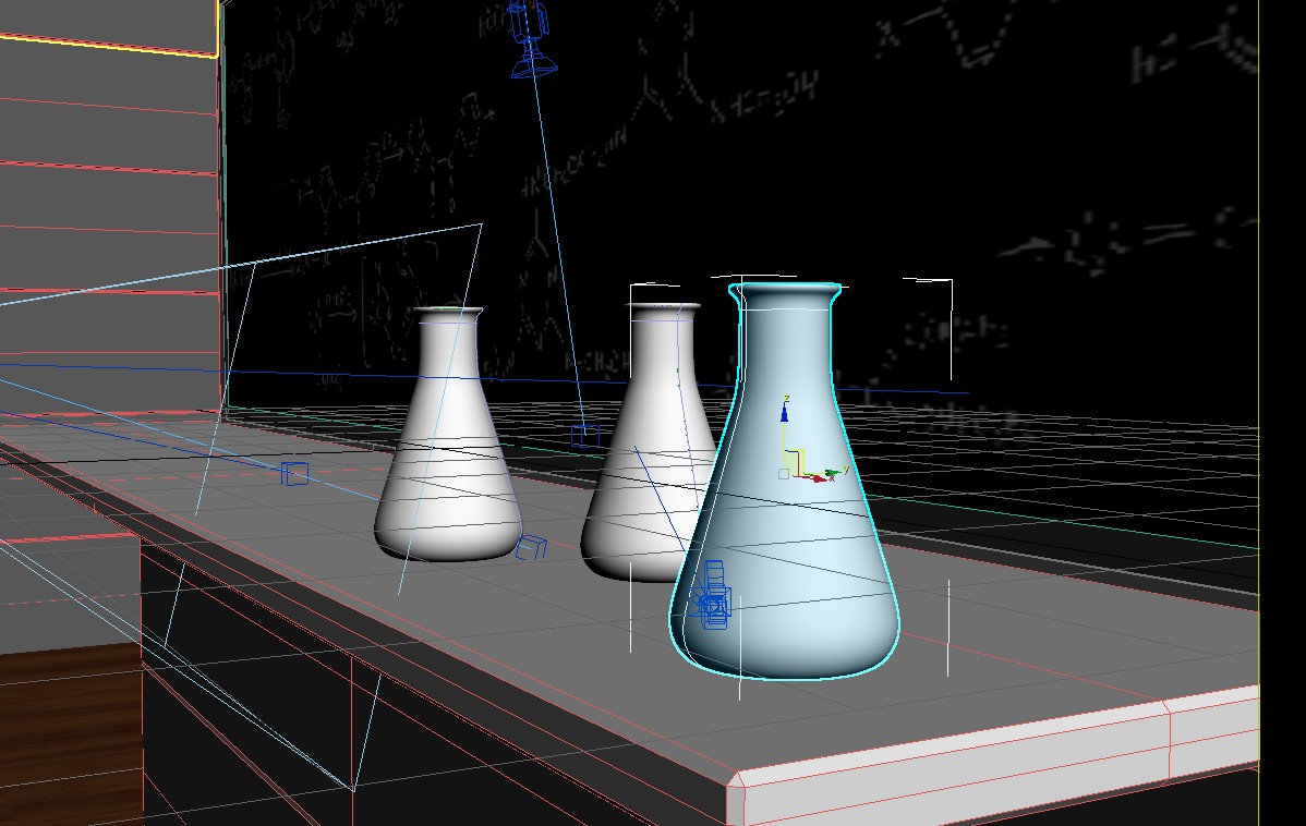

For example, in this scene, the glass has 2 different sides in each other with different normal directions that will cause the problem. the best way will be to remove the inside part and add a shell modifier to the remaining part or just remove it as it will not affect render anyway.
the front objects are one object that i moved and the rear objects have 2 layers of objects inside each other, if you look you can feel the difference.

both are great news, the one about linking objects and body objects support.TAO wrote: ↑Fri Mar 26, 2021 12:45 pm Add support for Body Objects, no need for UV map / Normal correction for dynamic material like glass anymore.

Of course, you still need to be careful about duplicate objects, there are many duplicated objects on the scene when you try to export Body Object from a few software.
Might this double face issue I have with this type of geometries be solve from alone one sub-Id will be supported? since there will be no need anymore to split geometries for different texturing need.
