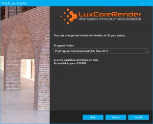

Moving MaxToLux installer to Wix to have a better user experience, look and also be opensource on this part of the project too.
TAO wrote: Thu Jan 14, 2021 11:21 am Moving MaxToLux installer to Wix to have a better user experience, look and also be opensource on this part of the project too.
It look refreshing and very nice. Will be even better with a more finished and polished background render ;) (maybe your last livingroom render)
