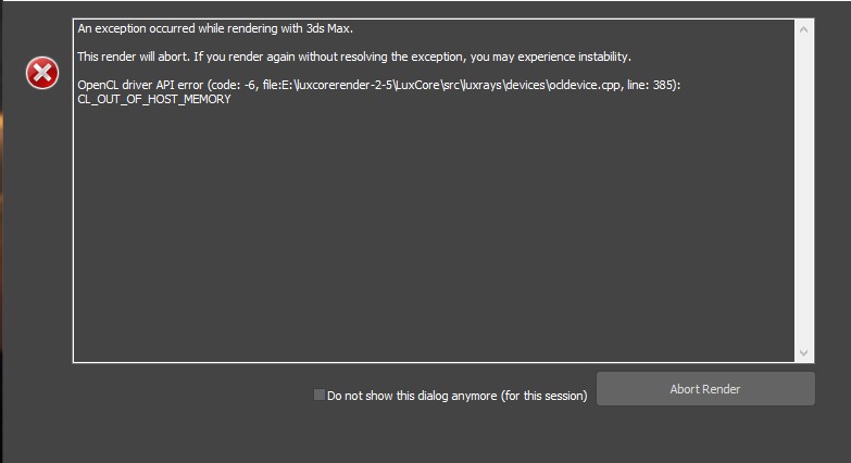

Blender crash with big HDRI or any png texture will take forever to translate and some time crash.
It's the same in render and interactive render. I have seen exact same behavior in 3dsmax and blender.
the error I get is different, sometimes out of memory, sometimes unexpected issues and in other times crash with no error.

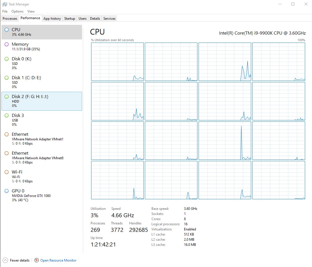

I do not know why is happening, I have at least 24 GB out of 32GB of ram available on my pc and 6 Gb out of 8GB Of GPU ram.

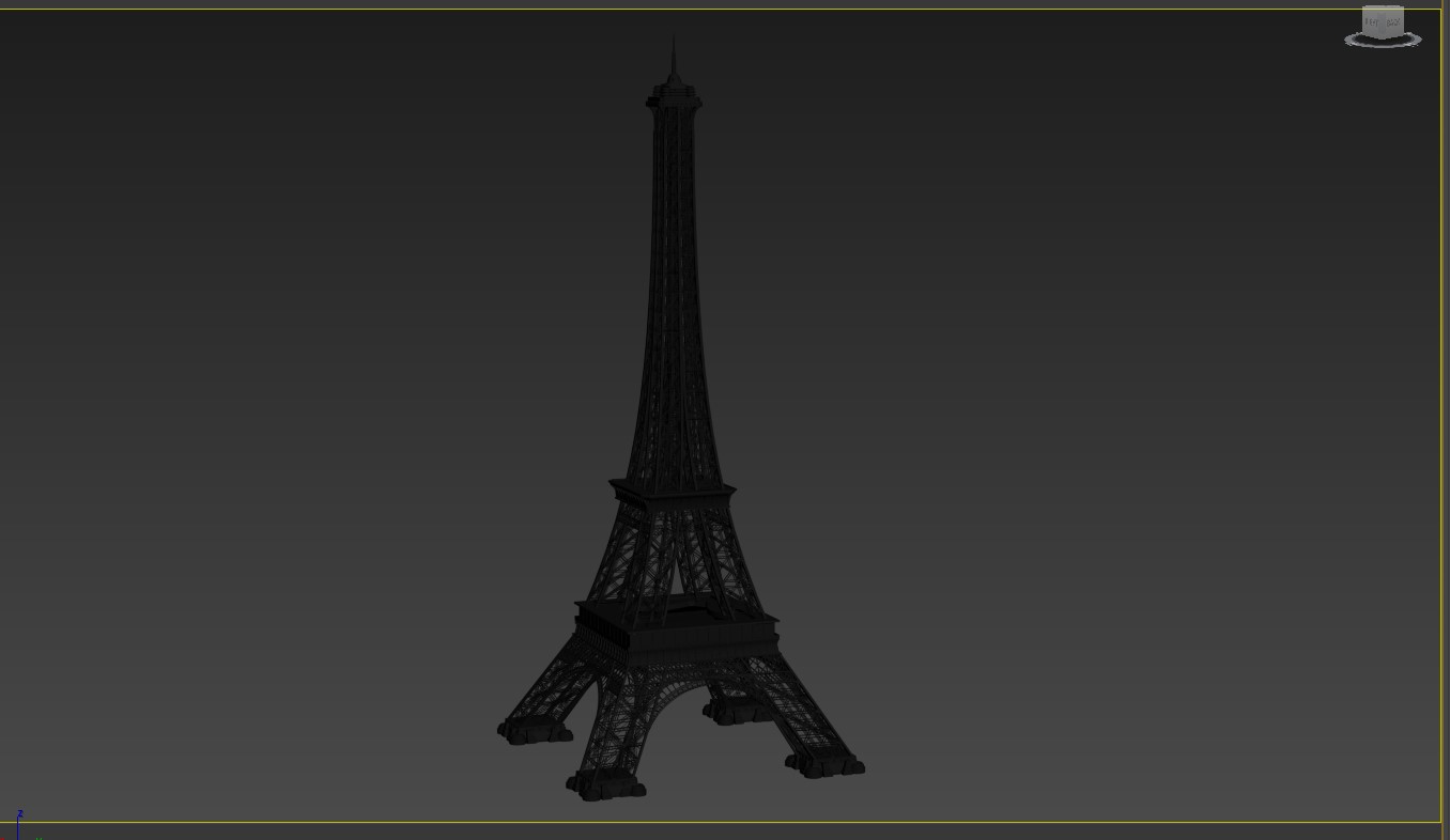

There is an Eifel tower in the scene to but it takes no time to translate.
The Eifel tower (Low poly).

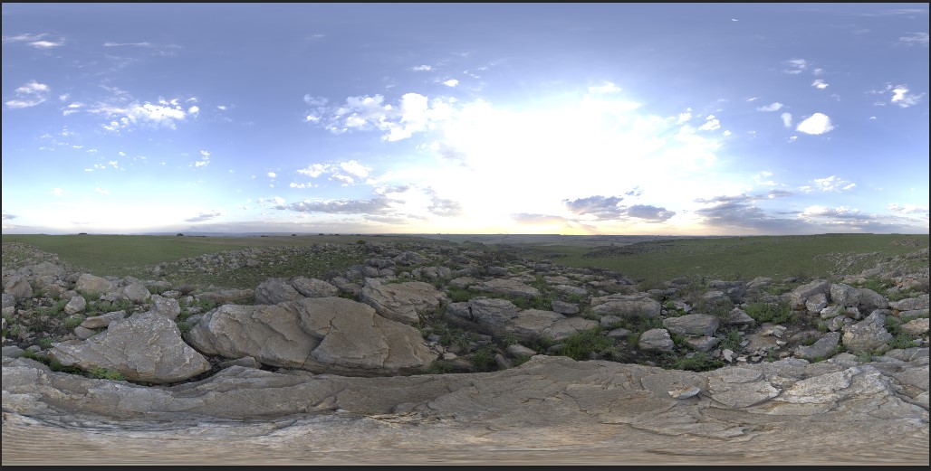

HDRI
https://hdrihaven.com/hdri/?c=skies&h=kloppenheim_06

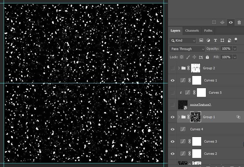

RainDrops

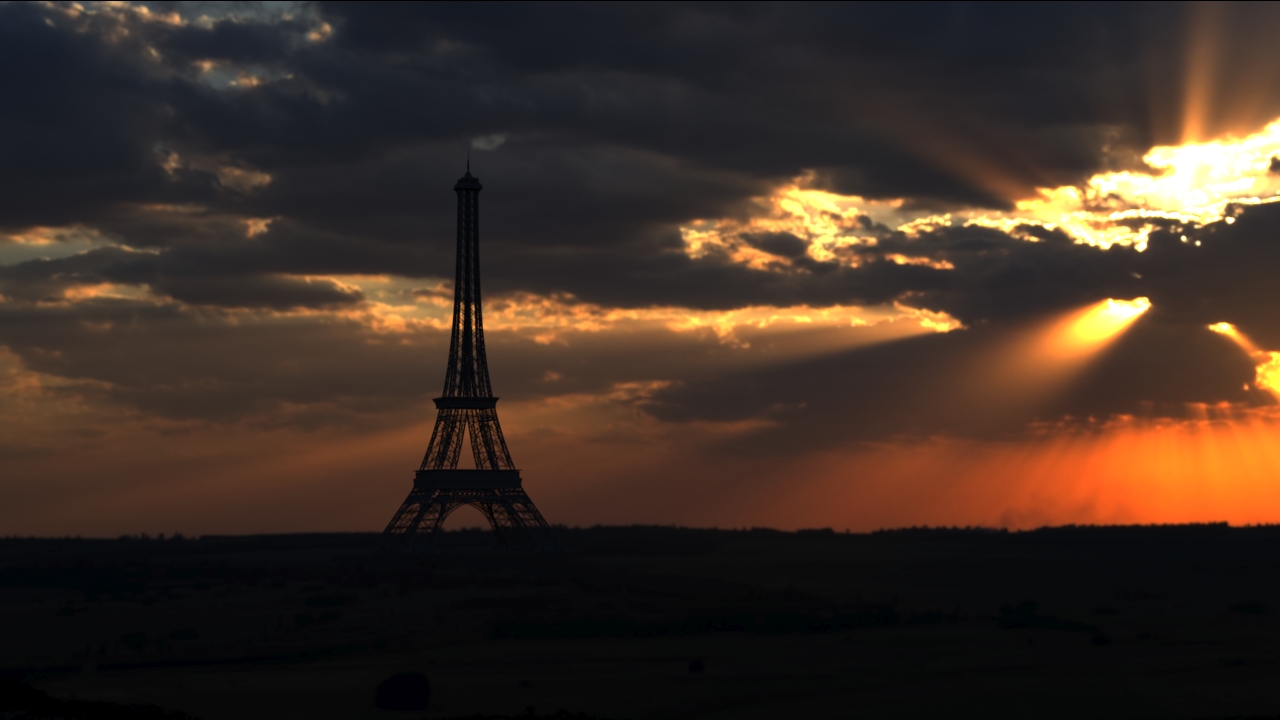

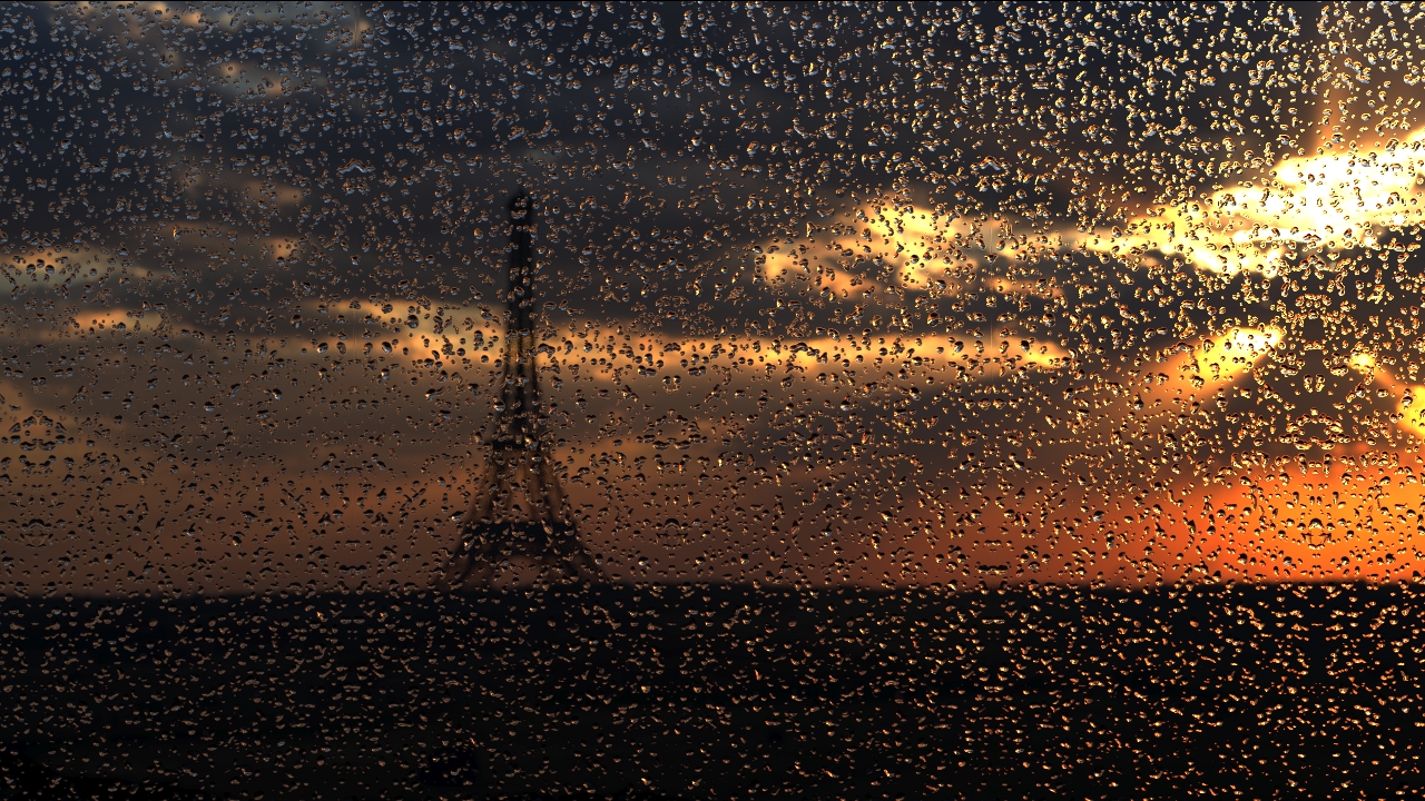

After a few crashes I manage to render the scene but it's unstable. here is the results.

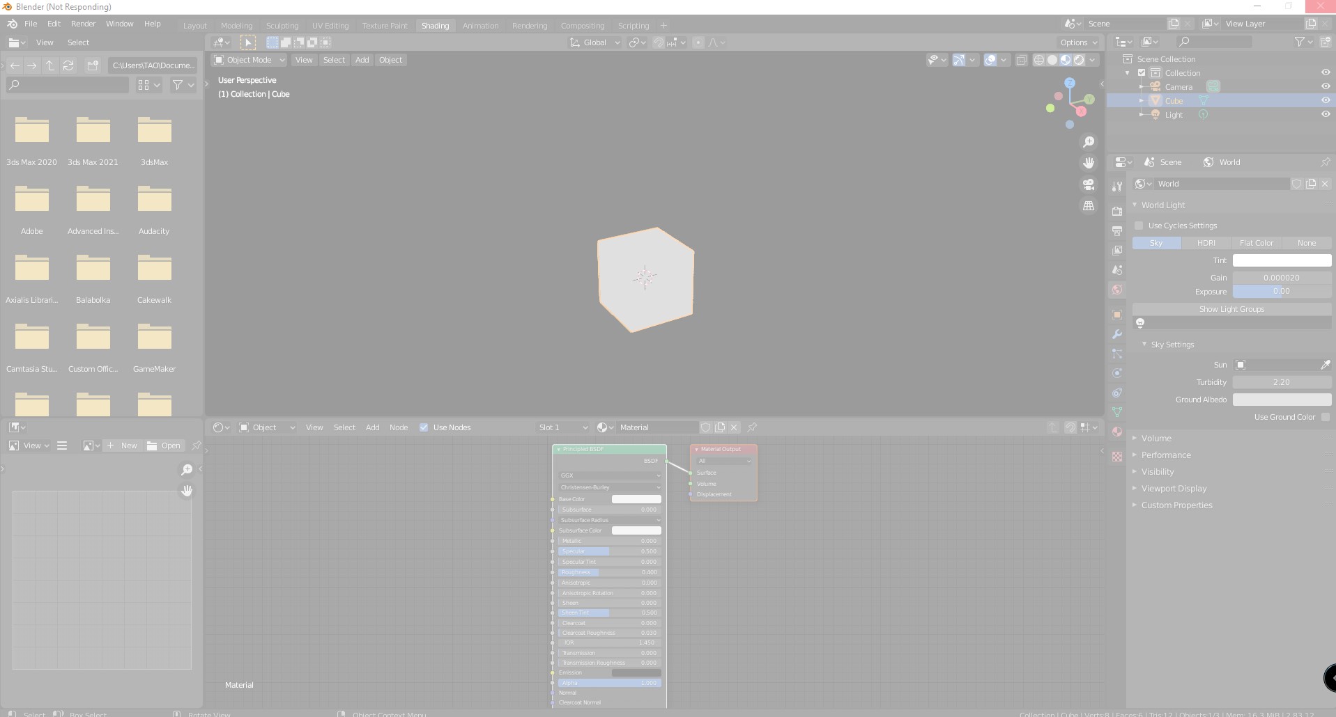

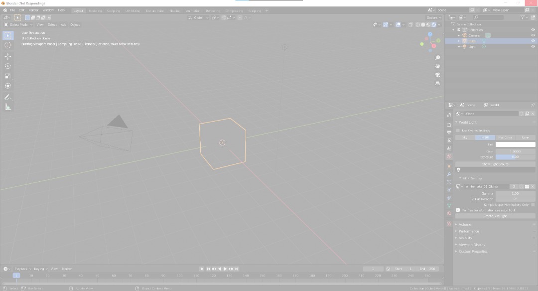

Step to reproduce the issue.
1- Select LuxCore as the renderer
2- Select any 16K/bigger HDRI as an environment map
3- Try to change the ENV gamma
Issues:
First, changing parameters is taken too much time compared to other renderers with the exact same steps.
Second, After a few try blender/3dsmax/LuxCore getting unstable and most likely crashes.
I think the issue is coming from converting all maps in LuxCore and not just use them. (it somehow no other choice with plugins like blender plugin)
Proof of concept:
Screen-Capture.mp4
(2.56 MiB) Downloaded 500 times
Sample scene:
http://3dfine.com/content/LuxCore-BigMap_Crash.zip
It can be reproduced with any other big HDRI, or Png texture, used on objects material or environment map.

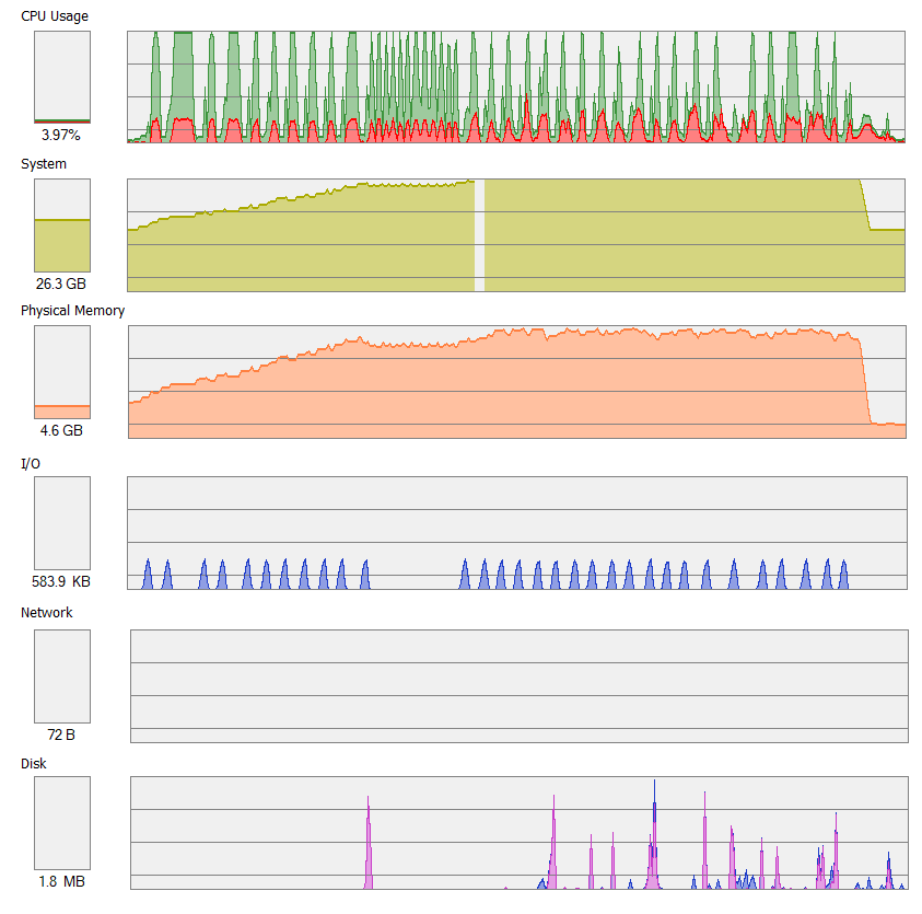

On my system (32 GB RAM) I do not get a crash when following your steps, however I do notice that while re-using the same viewport render session, changing the ENV gamma increases memory usage each time a unique value for gamma is entered (also, changing the gamma is very slow and cannot be done in realtime - I have to enter a value on the keyboard).
I can repeat this process and see the memory usage climbing in Process Explorer. However, if I re-enter a gamma value that I already used, it is both much faster, and also the memory usage does not increase. Thus I can concluded that these 'images' are cached somehow, and each unique gamma-adjusted image is kept in memory.
Once I go back to solid view, the memory used by all maps is freed, and goes back to the same level as before the viewport render started.
I guess your crash happens when your memory is filled? I could not repro a crash, I think Windows just keeps resizing my paging file as it gets slower and slower each time I increase a new gamma.
You can see in this image, I increase the gamma from 1.0, 1.01, 1.02, 1.03, 1.04, 1.05, 1.06, 1.07, 1.08, 1.09, 1.10.
Then there is a small plateau where I go back and repeat each one of these previous values.
Then I increase 1.11, 1.12, 1.13, 1.14, 1.15, 1.16, 1.17, 1.18, 1.19 - things start to really slow down as I hit my physical memory limit and it starts paging - 1.20, 1.21, 1.22, 1.23, 1.24, 1.25, 1.26, 1.27, 1.28, 1.29, 1.30
And finally you can see when I go back to solid view, all the memory is freed.

TAO wrote: Fri Feb 12, 2021 8:24 am System info that helps the case.
Hey, I have the same CPU as you :D I have 2 RTX 2080 Tis, not sure if that matters though because I saw the same behaviour in CPU rendering.

The white screen is because I click on the blender when it is unresponsive, also the blender will crash after a few changes on the game and then after that try to change the game to a number like 2.0 by typing the game value and hit the enter to set it.
Try that as I explain and let see if that's your case too.

Click+drag on the slider for me is basically not a viable option - it's not interactive at all as it takes multiple seconds to become responsive again. Also, you can see the memory usage increasing on the left side with every update.
TAO wrote: Fri Feb 12, 2021 8:47 am On slower PC changing parameters like gamma will take much more time especially when other PNG maps available on the scene and an unresponsive blender will cause instability eventually.
Agreed. Best not to do that while rendering, I suppose. It would be nice if the memory leak were fixed, though. I suppose it was not designed for this use-case, but rather it behaves as though it were used by multiple (different) scene objects - I suppose it can't tell the difference. Basically every time you change the gamma, it allocated another 1.0GB - 1.5GB of memory. :shock:
