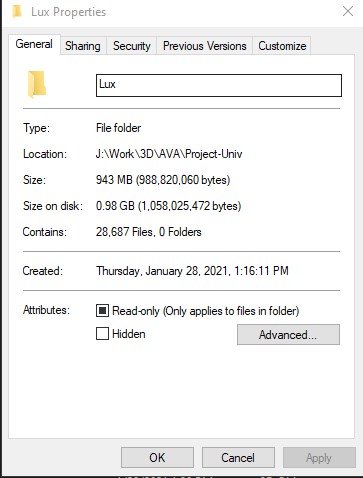

ost of them are different objects but I also have around 57000 instance objects that half of them are identical instance and the rest are instanced plus adding a few modifiers on top of them (I think that makes them a different object and not instance, not sure), I try to use instancing but I still don't know how to detect these objects are instanced from each other in 3dsmax, especially when I have a different modifier stack on top of a few of them.
One of the issues I faced is I don't know how to decide which objects are instanced and which is not.
The scene is too huge to be uploaded. around 1 GB.

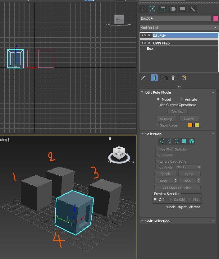

Here is a simple scene to start with.
In this scene, all of these objects are instances from the 3dsmax point of view.
Object 2 is an instance from object 1 and they are identical.
Object 3 is a copy of object 2, exactly the same plus on top of that add a UV modifier to change the UV scale.
Object 4 is an instance of object 1 plus mesh modifier on top of it. (reference object)
if object one change all other objects will change, if any modifier change on object 3 and 4 will not affect the other objects.
02-instance-test.zip
(325.84 KiB) Downloaded 262 times
Are these objects considering instance at all?

As I wrote elsewhere, you need to use the DuplicateObject method to create a large number of instances, it is the correct way to create them.
You need also to detect instances to save memory: otherwise you are duplicating the meshes and using an insane amount of memory.
The scene you posted created 4 different meshes while 1 and 2 should share the same mesh (not the others).
