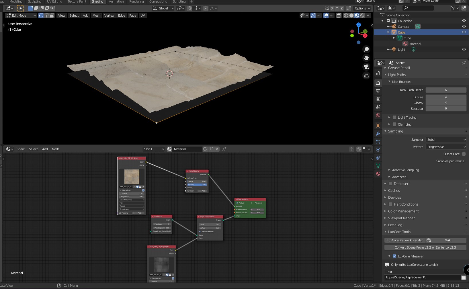

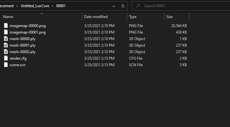

I tried to create a simple test scene for testing the displacement with just one plan and one shader. as long as i render it in Blender it was okay but when i try to save it by FileSaver it saves the completely wrong file with 3 objects and wrong materials.
I do not know why but i attached the project and lux Scene file for more investigation.

Filesaver won't help you investigate shapes anyway, it only saves the end result mesh of the shape evaluation.
I would recommend to check the LuxCore samples, the LuxCore shape source code and the BlendLuxCore implementation instead.

Thank you for the explanation but why there are 3 objects exported by FileSaver?
Because they are defined, even if not all used. In LuxCore, this is true for all geometries, textures, materials, etc.: if you define them they exist, even if not directly used in the current rendering (they may be in the future, after a scene edit).
You have to call RemoveUnusedImageMaps()/RemoveUnusedTextures()/RemoveUnusedMaterials()/RemoveUnusedMeshes() to remove all definition not used by the current rendering.

I see that's why there is 3 object instead of 2 when I save the scene by filesaver in a blender. honestly, I expect just 2 objects one for plane and one for displacement, and not 3.
