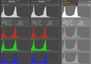

As shown in histograms below LuxCoreRender LCR renders images with extended dynamic. The difference is not very large, how ever it is good visible in the dark parts of the image. I guess this is an advantage for LCR when comparing versus Cycles.
- Histogram_LCR shows little more dynamic
Noise can be limited by enabling de-noising in BlendLuxCore's settings for final and preview renders. -For final renders a de-noise node can be added between in- and output nodes. There is actually not any reason complaining about noisy LuxCoreRender renders since Intel's open source de-noiser was implemented in add-on BlendLuxCore-LuxCoreRender and final in Blender.
