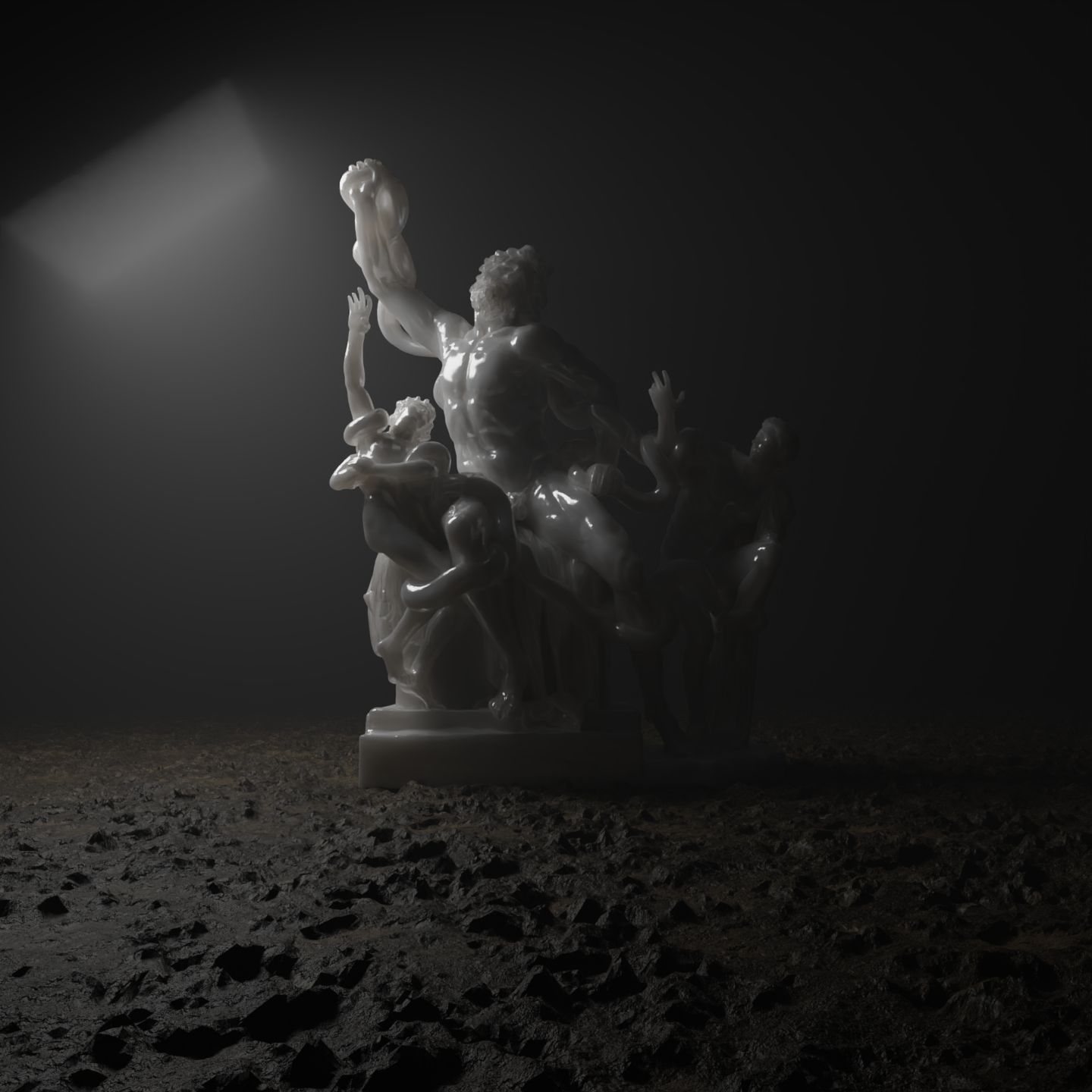

This is my first test with LuxCore Volumetrics, sorry if the solution has already been mentioned in the forum. I searched but no luck.
(Ignore the quality of the image, it's for testing purpose only)
Basically, I'm translating what I usually do in Cycles to Lux and I'm noticing something strange happening at the boundary of the ground plane.

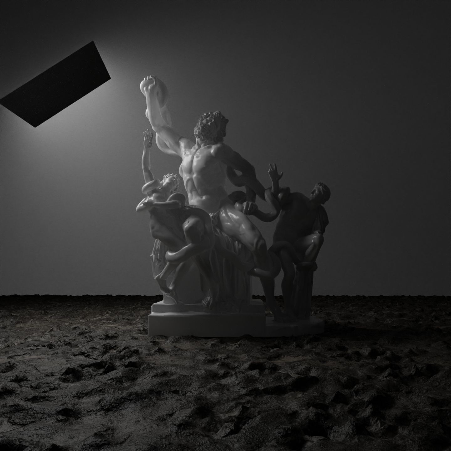

This is the same scene roughly translated for Cycles
As you can see, the background in Cycles gets more muted and the ground blurs into the environment in a more, gradual way.
In LuxCore there's a sharp separation between the ground plane and the volumetric.
On top of that, the light has sharp edges (having the light visible doesn't fix the problem).

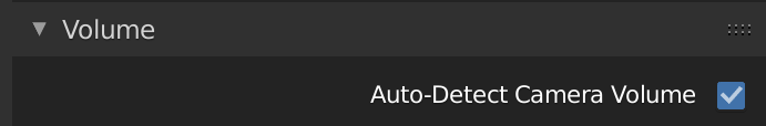

How do I do that?
Is it related to this?
Re: Volumetric breaks at mesh intersection
Posted: Thu Sep 03, 2020 5:38 pm
by B.Y.O.B.
Yes. Disable auto-detection, and you will be able to specify the volume manually.

B.Y.O.B. wrote: Thu Sep 03, 2020 5:38 pm Yes. Disable auto-detection, and you will be able to specify the volume manually.
Auto-detection only works if the surface in the middle of the film has correct interior/exterior volumes assigned (e.g. in your case, fog as exterior volume). However since it can be annoying to go through all materials and specify the correct volumes, you can instead specify the camera volume manually.

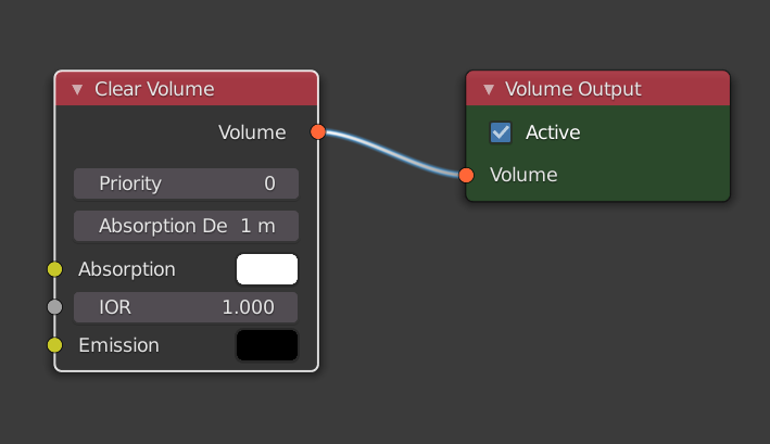

I disabled the Auto-Detect, created a new Camera Volume which has these settings by default
And now I guess I can simply have my cube with the Homogeneous Volume extending past the camera.
Do I need to change any setting in the Camera Volume shader?
At the moment the result hasn't changed, I'm back to the clipping issue in the first image I posted.

Posted: Thu Sep 03, 2020 6:56 pm
by B.Y.O.B.
If the camera is inside the fog, you need to set the fog volume as camera volume.
