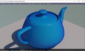

Re: v2.3 Vs v2.4 performance
I think thats gonna answer your question.
Posts: 814
Post by epilectrolytics »
This looks just alright, now that it is based on LuxCore 2.2 makes it very strange that you cannot achieve similar GPU performance with the very same v2.2 LuxCoreUI and your simple scene :?
Sorry to be of no help, but this problem needs smarter heads than mine to solve :oops:

You are great Dade, Not Only that fixes the issue but fixing this also fixes 3dsmax behavior too, and now it's much faster.
Thank you all.
