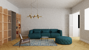

Posted: Mon Mar 23, 2020 4:16 pm
by PetrT
this one does not rendered in 1080 with 256 px and 16.shows black screen.It is not too complex
Can not find exact example maybe later
Re: tiled rendering for 8k,4k image
Posted: Mon Mar 23, 2020 4:23 pm
by B.Y.O.B.
16 AA samples with such a big tile size is a lot. Using more AA samples requires more memory, if I remember correctly.
Posted: Mon Mar 23, 2020 4:24 pm
by Dade
PetrT wrote: ↑Mon Mar 23, 2020 4:16 pm
In LuxCore, rendering a tile at 256x256x16 AA is like rendering an image with 256x256x16 pixels so it is like rendering an image at 1K resolution. Plus Lux is also rendering multiple tiles at the same time so you are probably using a LOT of ram for the image.
Just use the default tile size, something like 64x64x16 or even smaller. It should solve your problem.
