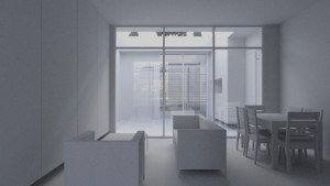

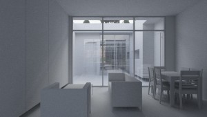

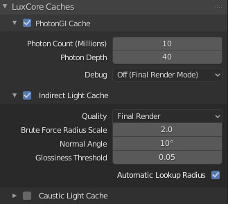

Hi guys ! before i can deep dive into the war between theses two engine i want to make sure everything is set to the correct way.
At the end this should lead to a better understanding of the key benefit from a spectral engine Vs RGB renderer. The is done with the same HDRI all deph 40.
Octane Render 2.35 mn
Luxcore PGI 2.43 mn
Luxcore Path 10.44 mn

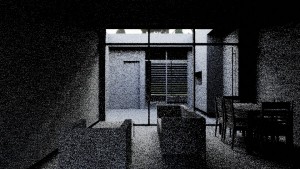

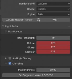

Without Caches algo i really wonder how octane manage to strike a so clean image in just 2.35 mn (A kind of AI or clamping ?). Luxcore PGI is fast but loose lot of light details while being darker.
Luxcore pure path can be faster but it is really hard to remove hotpixels without loose too much light details ( render become darker and darker). Note also that both engine use transparent shadow for glass.

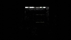

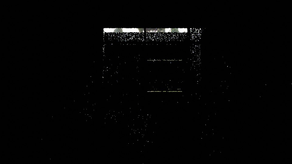

More test this time with direct light only. max bounce = 1 Max sample = 1 for both.
Octane
Luxcore
Observation :
Look like Octane is using a kind of heavy direct light clamping that kill everything even though Clamping by default is set to 1000000 in octane.

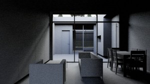

Now Direct light with more samples per pixel (500) :
Octane Max deph 1 + 500 samples
Luxcore Max deph 1 + 500 samples
Observation
Even with more samples per pixel look how dark the octane render is. now wonder if we can clamp direct light alone in Luxcore too at some point.

Luxcore is always using whatever you input +1 bounce, that's how exporter is set up, Simon pls. Correct me if wrong.
