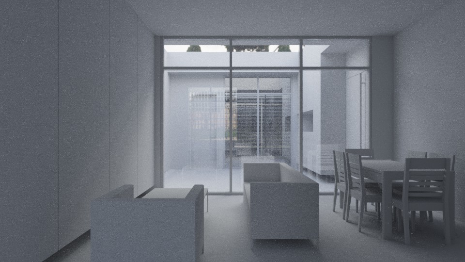

Hi guys ! before i can deep dive into the war between theses two engine i want to make sure everything is set to the correct way.
At the end this should lead to a better understanding of the key benefit from a spectral engine Vs RGB renderer. The is done with the same HDRI all deph 40.
Octane Render 2.35 mn

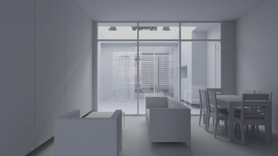

Luxcore PGI 2.43 mn

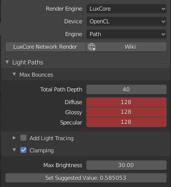

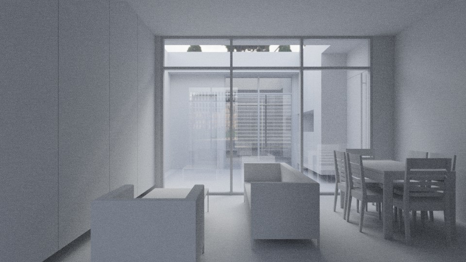

Luxcore Path 10.44 mn
Without Caches algo i really wonder how octane manage to strike a so clean image in just 2.35 mn (A kind of AI or clamping ?). Luxcore PGI is fast but loose lot of light details while being darker.
Luxcore pure path can be faster but it is really hard to remove hotpixels without loose too much light details ( render become darker and darker). Note also that both engine use transparent shadow for glass.

Have you noticed that the HDR background has different orientation between Octane and LuxCore rendering :?:
Re: Luxcore Vs Octane Preparation test
Dade wrote: Thu Jan 30, 2020 12:09 pm Have you noticed that the HDR background has different orientation between Octane and LuxCore rendering :?:
Yes just slightly octane transformation node is not very smooth and precise in addition it doesn't work when you enter precise number . you have to manually play with the slider to see change in the viewport. But this doesn't change the Performace/quality story here. But anyway for consistency i've update luxcore render.
