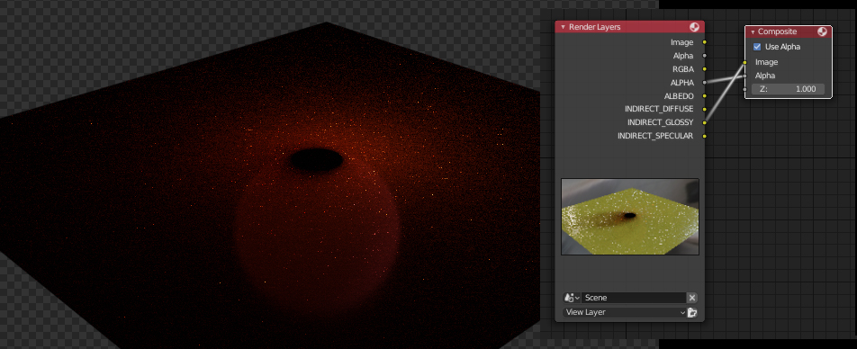

Well, now it looks like this:
So, how to remove black area and leave only glossy? I tried to add diffren keyers in compositor, but somehow they do not work.

Re: Indirect specular\glossy with alpha
Post by Egert_Kanep » Tue Jan 21, 2020 7:22 am
No need to key, you could pull luminance key if really wanted. But aov's are supposed to be added together. Perhaps you need something else than indirect glossy
