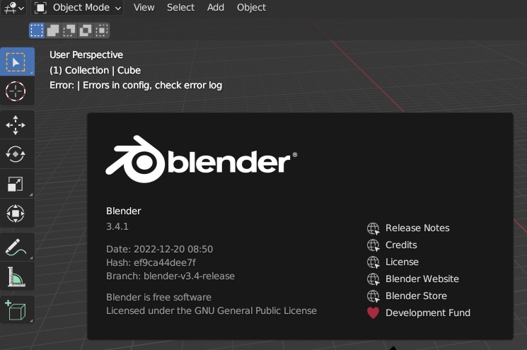

I really hate to be the person that keeps nagging and saying it isn't.
Last build of 17h ago, in 3.41 installs, but when you switch to rendered view gives unspecified error:
I don't know to what error log it refers to, couldn't find any in my temp folder (open $TMPDIR), or any other relevant locations like Home or Blender App support in Library.
I ran Blender trought terminal with debug (don't know if there's a specific flag for Lux)
Debug file:
https://drive.google.com/file/d/1jyei1G ... share_link
Then the same release runs just fine after it compiles kernels in 3.3. But going back to 3.4 has the same behaviour
:shock:

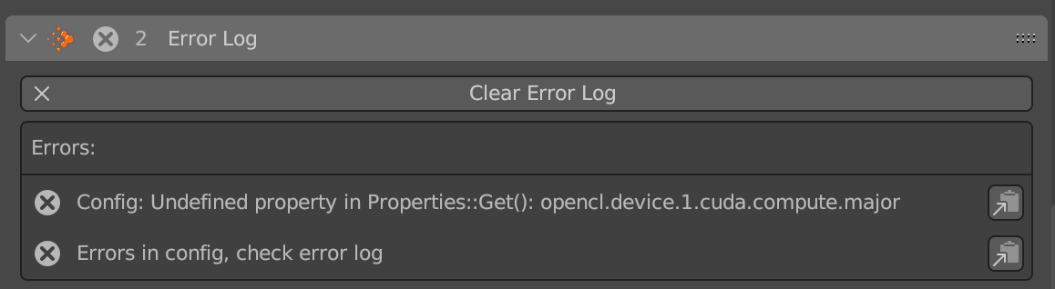

You can find it here ... i had something similar but after rendering the viewport works ...
The jpeg error is gone though.
what is you error ?

Same as yours? CUDA? :roll:
And yes, its viewport only, it renders fine, even the Oranje Juice scene that was throwing errors.

No that was not the problem ..
File "/Volumes/TOSHIBA_EXT/GitHub/Blender_Addons_2020/addons/BlendLuxCore/ui/render/viewport.py", line 68, in draw
can_use_optix = viewport.can_use_optix_denoiser(context)
File "/Volumes/TOSHIBA_EXT/GitHub/Blender_Addons_2020/addons/BlendLuxCore/properties/viewport.py", line 71, in can_use_optix_denoiser
if data.Get(prefix + ".cuda.compute.major").GetInt() >= 5:
RuntimeError: Undefined property in Properties::Get(): opencl.device.1.cuda.compute.major
seems to be a missing property ... now it is time to ask if this is only macOS ... does anyone have this problem on win etc ?
I recently added this check to only run OPTIX denoiser on newer Nvidia cards but this seems to give an error for non NVIDIA cards. I will push a fix soon.
