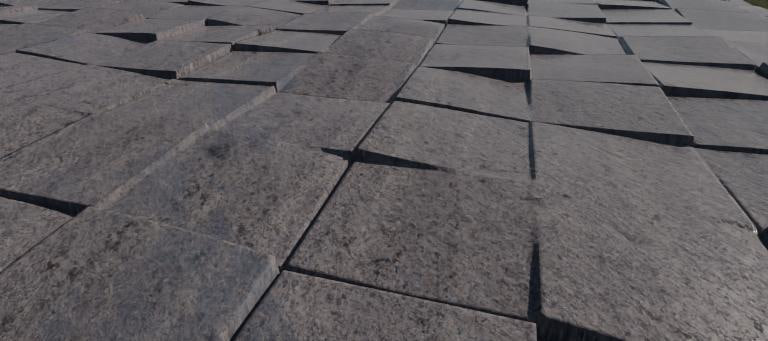

Hi CodeHD, thanks for you availability. The issue we had was caused by the multithreaded texture loading which we implemented in luxcore for 10x faster scene loading in ultra large scenes. Apparently this code is not present in the public luxcore release, so don't worry. We had to make an exception for displacement related textures and now everything works smoothly.
