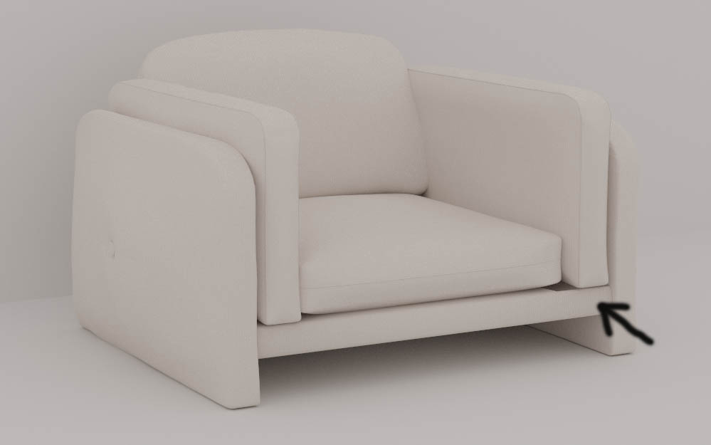

I seem to be getting some hard shadows when using the Cloth shader

That's shading issue. Either add supporting edges to mesh/geo or apply "Auto Smooth".

The valance mesh is the problem set it to auto smooth with 89 angle.
