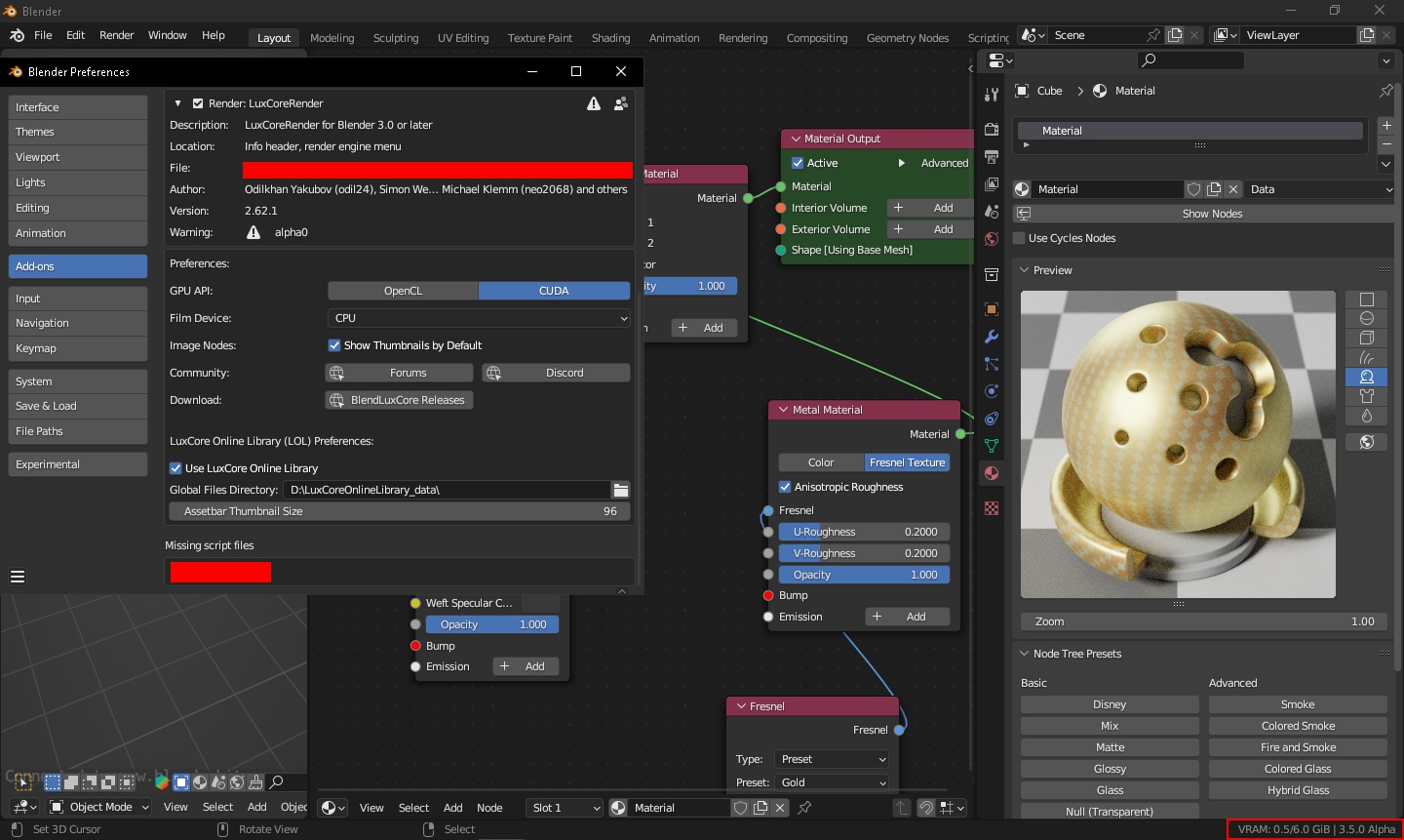

Re: odil24's own repo for LuxCoreRender development
I've installed the latest nightly build, seems working (I've done a quick test) but the multi materials setup isn't working.
BlendLuxCore uses just the first material.

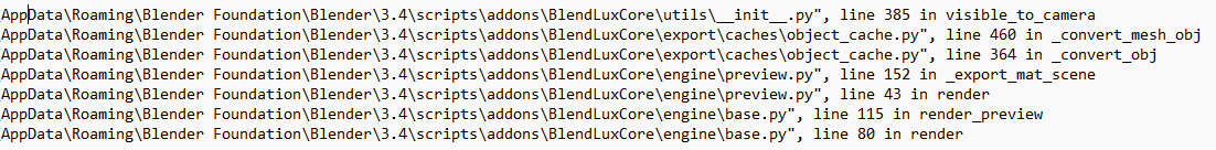

Blendluxcore lastest and blender 3.4 have tis issue Plus instant crash when opening the material render preview in properties panel.
It lead to something like this :
https://github.com/LuxCoreRender/BlendL ... issues/799
In blender 3.4.1 release candidate the material preview works but assigning multiple materials to an object not working.
