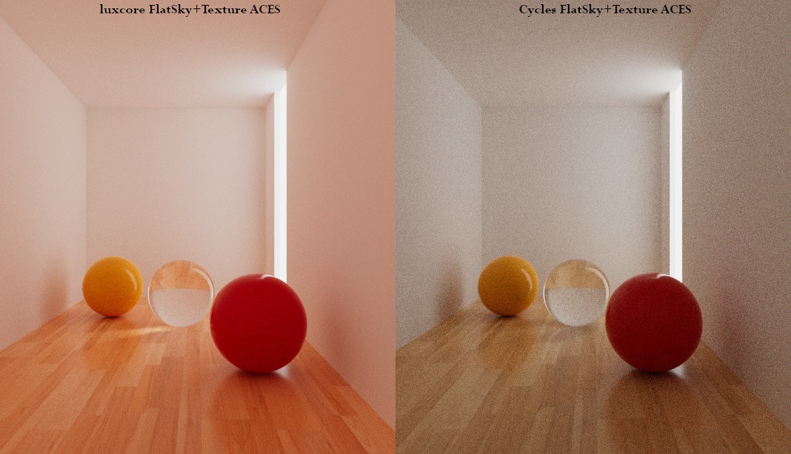

Cycles ACES vs Luxcore ACES Flat color Sky + textured floor
Cycles ACES vs Luxcore ACES HDRi + textured floor
Second Conclusion : As soon as texture are involved huge difference spike due to the fact that it isn't yet possible to set texture input color space in Blendluxcore even if the core engine support it
So look like we just need this option to specify texture input color space and we are good to go with ACES in Luxcore.

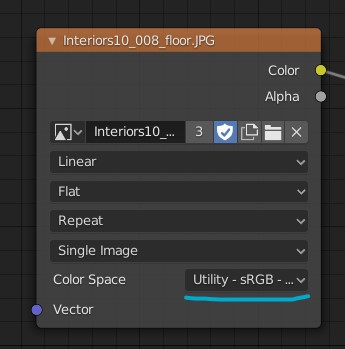

1_Texture input color space
2_Hdri Color space
3_maybe there are some other part for texture input color space but you get the point.
How it look under Cycles :

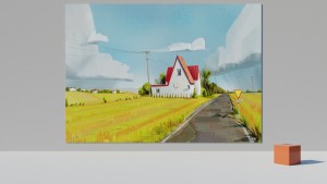

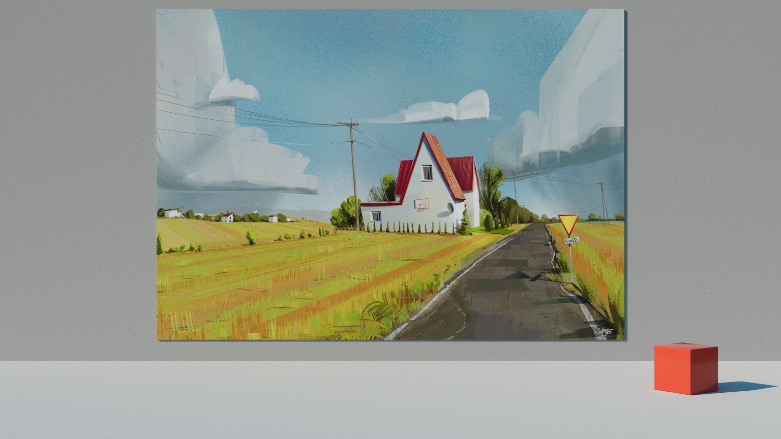

The images were rendered in blender 2.92, cycles and blendluxcore 2.5.
To match the scene results in cycles the house texture is a jpg in utility srgb texture colorspace and the hdr light set to acescg colorspace,
in blendluxcore the house texture is a converted exr with gamma set to 1 in the image node settings.
cycles aces display device, rec.709 view transform
luxcore aces display device, rec.709 view transform
luxcore filmic high contrast look
luxcore filmic medium contrast look
You can use Krita or Affinity photo to achieve the proper color space that is utility srgb texture you choose in cycles.

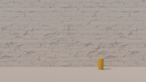

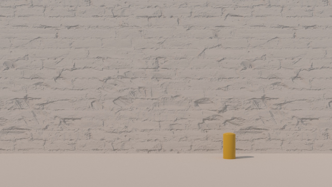

For greyscale images such as specular and roughness maps you can just set the gamma to 1 in the image node settings, there seems to be no need for conversion. Also for the normal map texture you can just use it as usual, no need to convert it.
In the following example i used a specular, a roughness and a normal map texture. The same textures are used both for cycles and luxcore without a conversion, only the gamma is set to 1 in luxcore image nodes. The textures for cycles are set to raw colorspace.
luxcore aces
cycles aces
