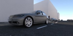

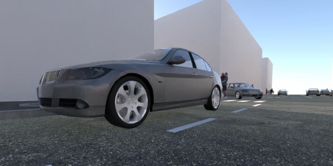

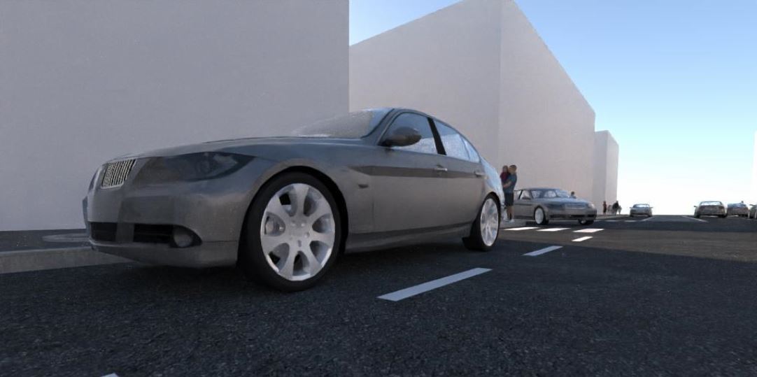

I encountered this bug because suddently, in an exterior scene, an asphalt material which uses a mix node + two disney nodes, was not receiving shadows correctly. Then i discovered that i was getting the correct brightness only by removing the mixed node.
using mixed
single disney only

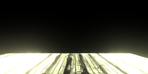

The attached scene is a simplified set-up of the same problem.
It's a closed box with an environnment outside.
the camera is inside the box.
To the base of the box i applied two mixed disney nodes. Each disney node has a bum map.
In theory, being the box sealed the resulting image should be completely black.
Instead, i get this:
if i keep one single disney node with the same bump applied the result is black as expected.
So it seems a mix+bump problem
mixedBug2.zip
(1.66 MiB) Downloaded 1019 times

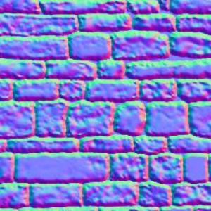

The scene includes the definition of some very strange normal map:
used as a normal map:
scene.textures.92411_1_sub1_normal01.type = "normalmap"
scene.textures.92411_1_sub1_normal01.texture = "92411_1_sub1_normal01_texture_mergeColor"
scene.textures.92411_1_sub1_normal01.scale = 0.25
This is wrong because the above image clearly not a normal map (i.e. it is a bump map). This is likely to be the source of your problem.
Normal maps have a very specific look, they looks like this:
where the R, G and B channels are used to encode the X, Y and Z offset.
