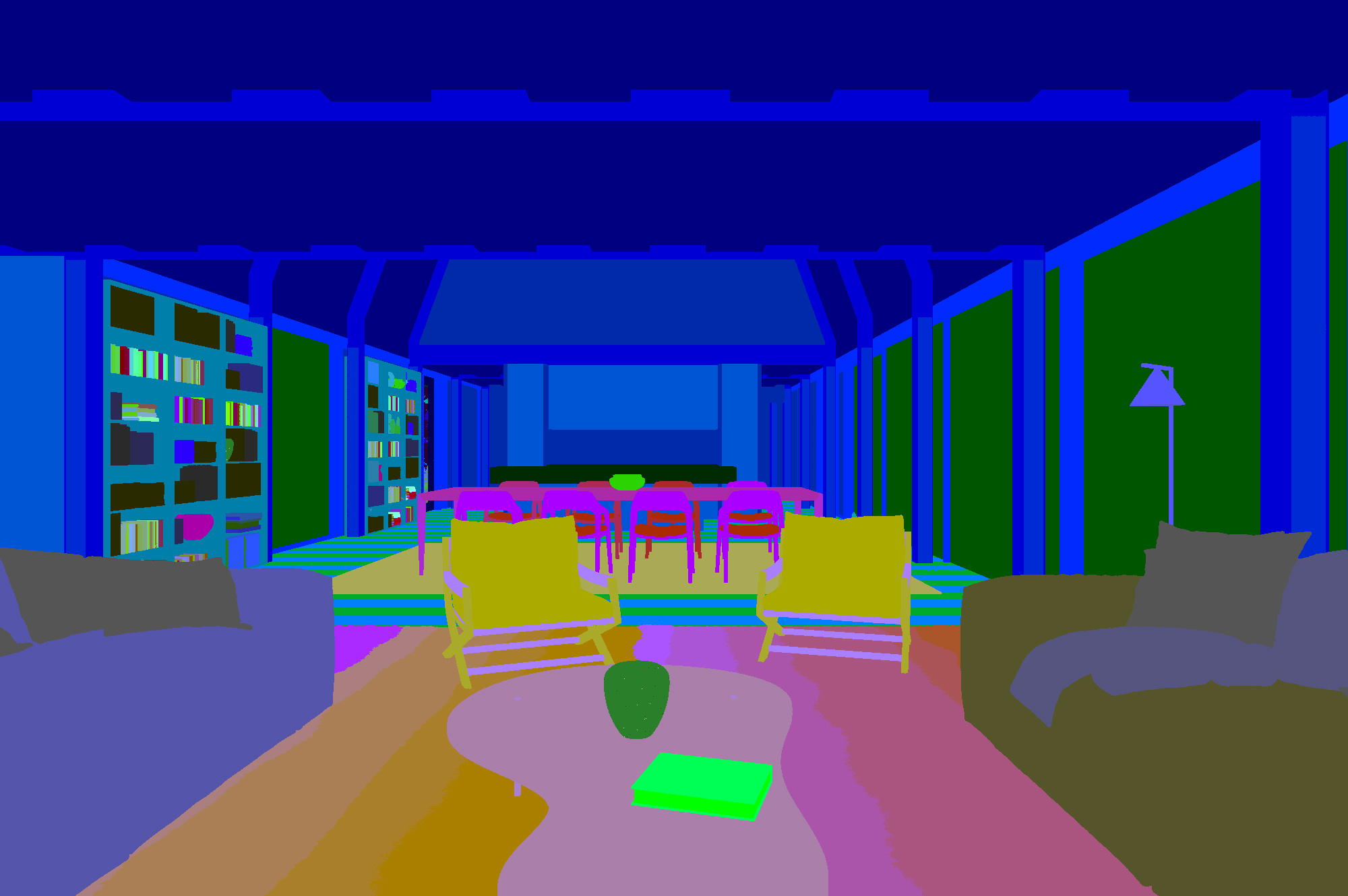

Hi, is there a way to have those material ID's antiliased? If antialiesd they would be suitable for basic (not perfect) masking.

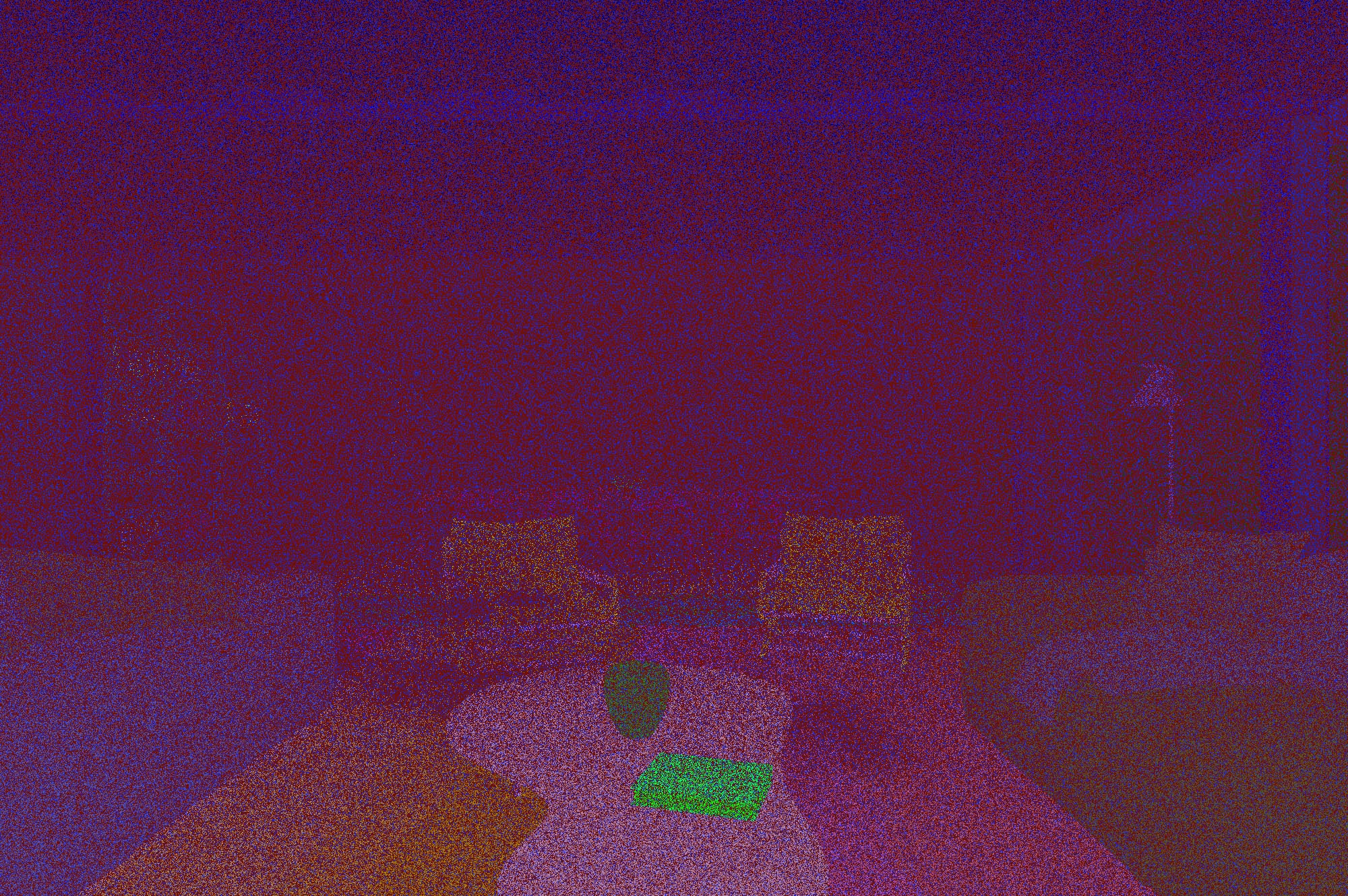

By the way they do not work inside volumetrics.

There's a special AOV with anti-aliased material IDs, I think it's called MATERIAL_ID_COLOR.
The best thing though would be to have cryptomatte, but that's not implemented in LuxCore so far.
