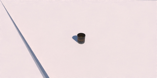

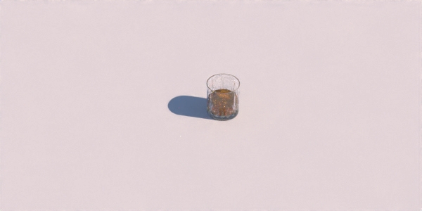

Hi, have two verys simple scenes, just a few polygons and a glass of whisky.
One scene is 3km big and the glass is rendered well, the other is 800m big and the glass renders dark.
If this is still a precision problem why the bigger scene renders well?
3km scene
800m scene
Thanks for any help.

Re: question about glass
The glass is at origin in the "transparent" scene:
scene.objects.903860_1_0_0_0.transformation = 1 0 0 0 0 5.960464e-08 0.9999999 0 0 -0.9999999 5.960464e-08 0 -0.0654683 0.0806955 0.04439508 1
while is more than 155m away in the "dark" scene:
scene.objects.903860_68_0_0_0.transformation = 1 0 0 0 0 5.960464e-08 0.9999999 0 0 -0.9999999 5.960464e-08 0 155.682 53.4093 0.0443833 1
As explained in the past (the message quoted here => viewtopic.php?f=4&t=3829&p=31635#p31627), floating point resolution is lower and lower more distant you are from the origin: the intersection of the exist surface of the glass starts to be missed so the ray travel for an infinite amount of times inside the absorbing volume.
