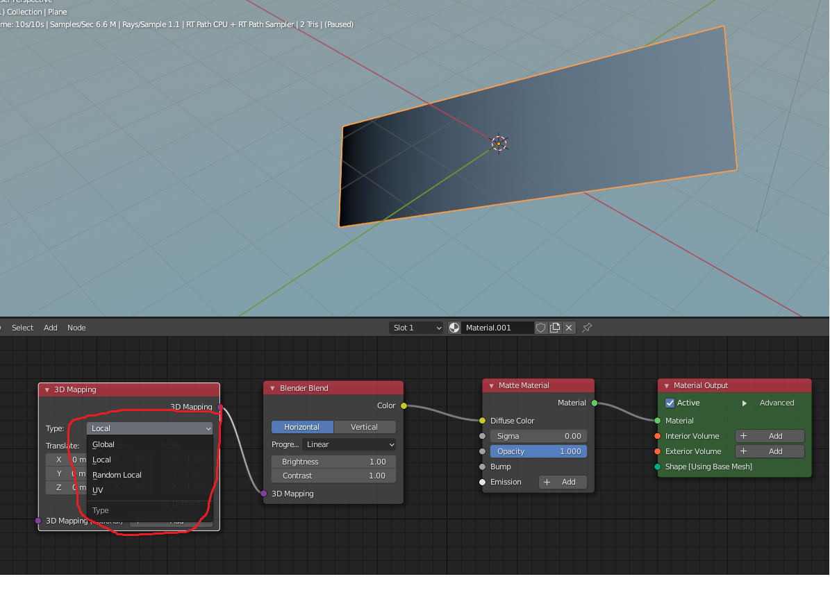

You can change the mapping type to UV or local.
