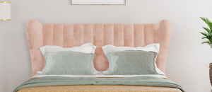

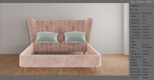

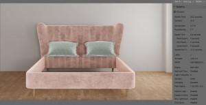

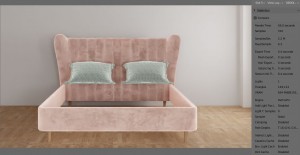

Have problem with PhotonGI cash
Why shading become broken?
Is it well known fact
with cash
without cash
win 10
last build luxcore
Blender 2.93
Lightning
Env (Flat color)
Photon Cash params

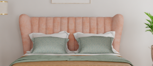

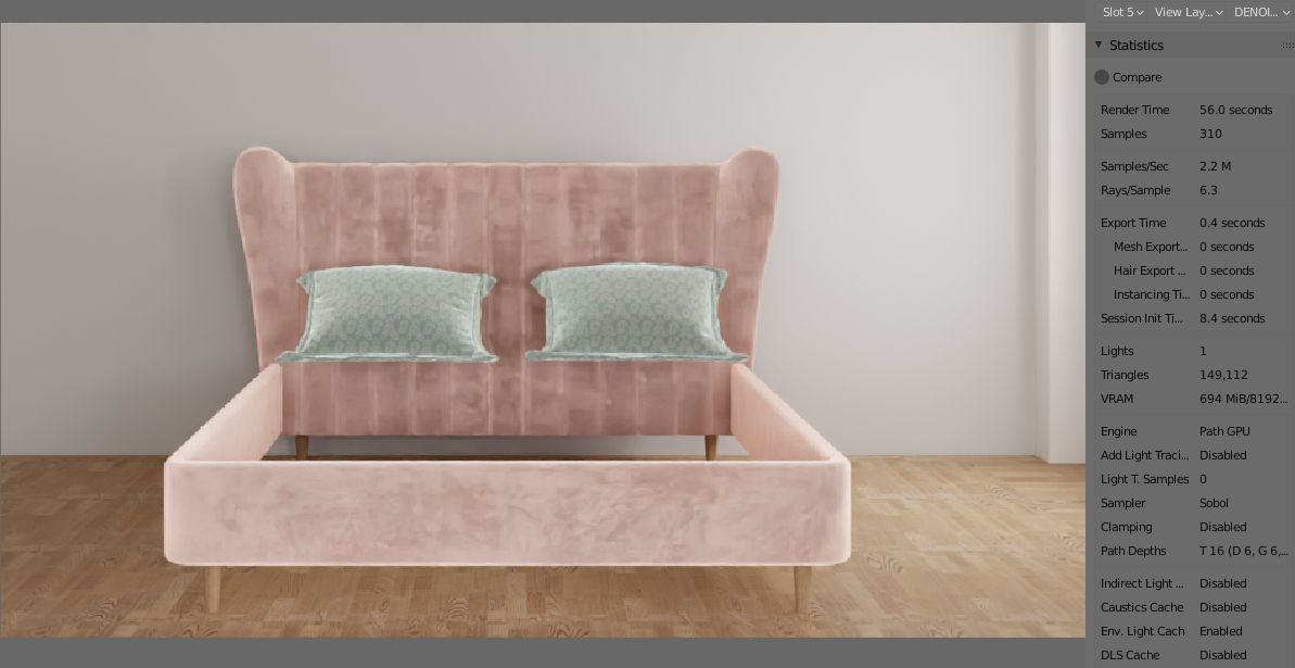

Re: PhotonGI cash problem
Use of PhotonGI Cache makes results a bit darker.
Not sure, but I think it was already mentioned...
0 - no caches (reference)
1 - PGI (darker)
2 - PGI + ENV (darker)
3 - PGI+ENV+DLS (darker)
4 - ENV (bright as reference w/o caches)

Have you tried to just disable PGI for the material of the bed ?
Posts: 821
Dade wrote: Mon Aug 30, 2021 10:19 am I'm looking in a Disney material related problem and I will check this as soon as I have finished there.
There's no Disney material used.
Bed & Pillows use Velvet, Walls - Matte, Floor & Structural framing - Glossy+Matte
Disabling PGI on a bed (Velvet) material helps a bit but not fully. And disabling it on Floor, slightly darkens a bit...
I'm thinking it might be Blender's "fix" for color values causing this by influencing Glossines Threshold... or it's just how this scene is set (I haven't gone through all details, since it's a bit of disorganized mess :roll:
Just try what he is saying. It should work fine without speed penalty. Just disable Cache on the darkening material.
