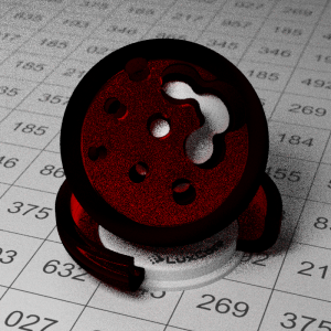

I've done the pure transmittance part for Disney material I hope (see the red ball :)). Now I want to combine it with the rest.
