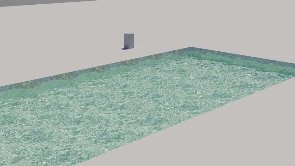

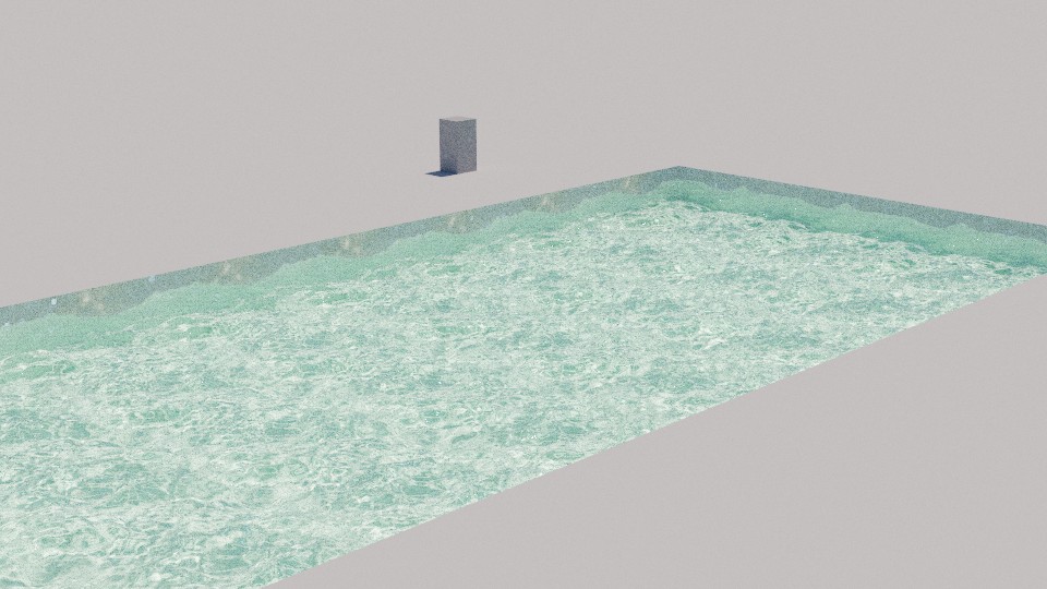

Hi just testing cautics cache on different scene size and just catch a weird behaviour :
The pool brightness vary according to scene size.
Smaller ground plane give darker pool :
big ground plane give brighter pool :
Here is the blendfile: you can just increase the ground plane by 10X to see the difference:

The total size of the scene affects where the rays for sun, sky and infinite lights are emitted from (they are emitted from the bounding sphere of the scene). Also floating point numbers have less and less precision farther you are from the origin. This is likely to be the source of your problem.
Metropolis is likely to start to have numerical precision problems: it will have to hit a smaller and smaller pool, larger the scene is. Quoting myself from another post:
Something that works at a scale X or position XYZ, will not work if scale up or translated far from the origin.
