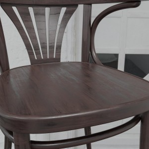

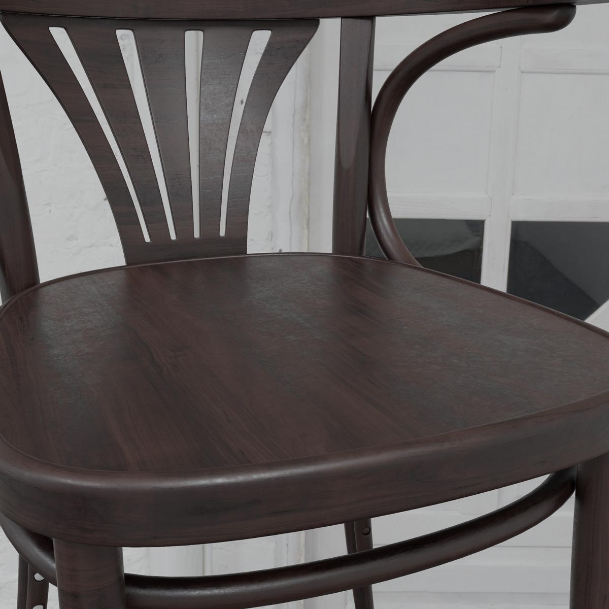

I try to combine 2 different roughness maps to give the material even more variation. So my plan was to use the color-math node and switch the mode to "mix". As I understand "Fac" regulates how much of which rougness map I can see. When I try to do the same in cycles I use the mix rgb node and it offers even more blending modes like "overlay" which seems to give more the result what I am looking for. For me it seems that "overlay" gives a better representation of both roughness maps at the same time. Is there something similar in luxcore like "overlay"?
I attached 2 pictures and maybe you can see what I mean.

Classic bump mapping is not additive (i.e. if you add/mix 2 bump maps, the result is not the sum of the bumps). So operations over many bump maps are not very intuitive. There have been alternative solutions proposed over the years but pretty much everyone are still using the same classic bump mapping algorithm.
Said that, you can just pre-process the bump maps in Gimp/Photoshop/etc. and then use the baked result. There is is really no reason to mix the images at rendering time if you can mix them as pre-processing (i.e. pre-processing is faster). I think you can even bake the mixed bump maps in Cycles and than use the result in LuxCore.
Re: Question regarding Mix-Node (Color Math)
You can google how the "overlay" algorithm works in detail (it should be a rather simple equation) and perform it with math nodes.
For example here: https://www.deepskycolors.com/archive/2 ... modes.html
@Dade: Mael2 is talking about mixing roughness maps, not bump maps.
