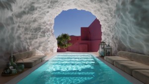

DOn't know if someone else get into the same issue but I'm running an animation with persistent PGI/ENV cache and i get huge flickering due to
the fact that cached files are sometime not loaded by Luxcore. here is the result :
Animation_Test
Poo_1l.mp4
(413.9 KiB) Downloaded 287 times

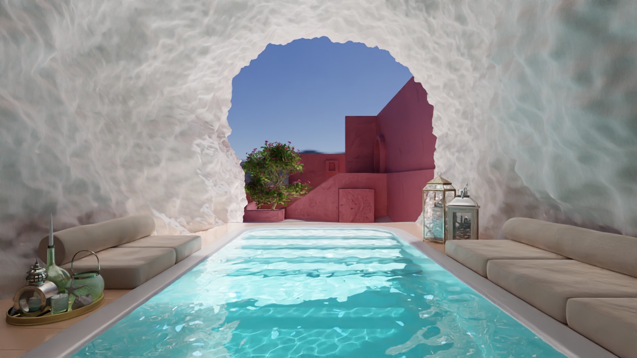

Here when cache isn't auto loaded

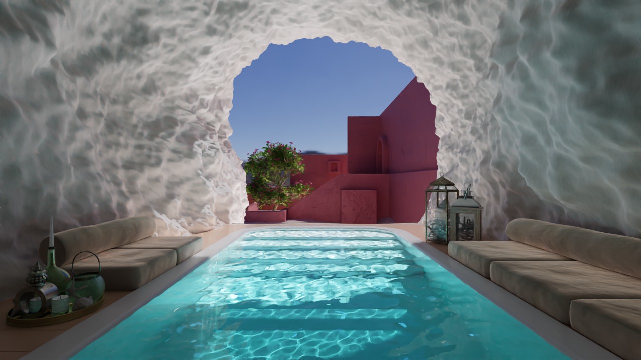

Here when i manually load cache file
and it is what happen during the animation rendering cache file are randomlly loaded and unloaded.
Making the final result to switch between bright and dark look constantlly.

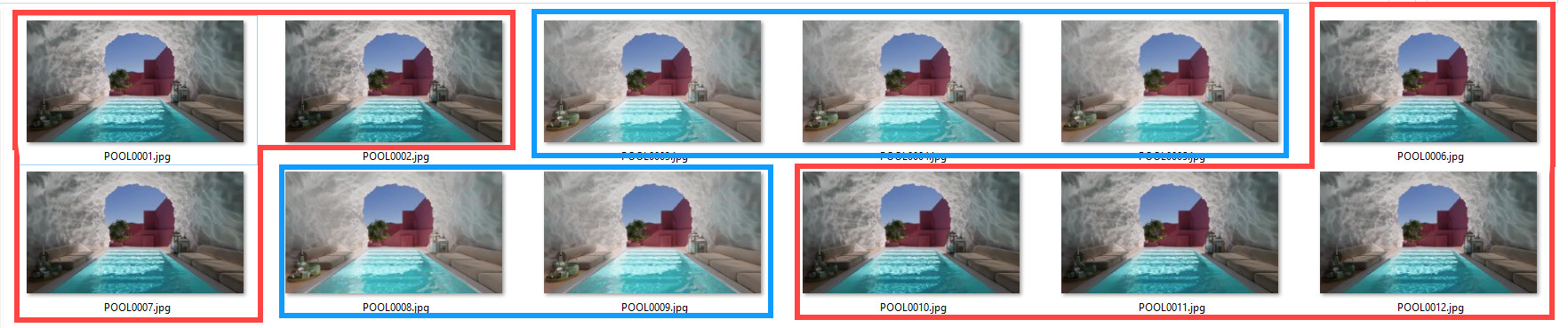

Here you can see how it look like on frame folder. Darker frame randomlly sisde by side with brighter frame :
