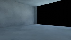

I have a large Background plane that I want to appear as background (in render) not affecting anything but camera.

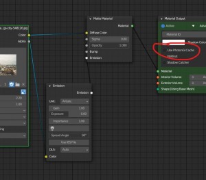

Right now I can disable shadows and use emission on the plane, I can also disable "use photonGI cache".
However this will still generate pgi entries and since it is a large object far away I will end up with very few entries inside my environment. That also causes poor pgi quality and performance.
no background only simple lighting
with background that is supposed to be backplae
this option doesn't affect the issue in any way

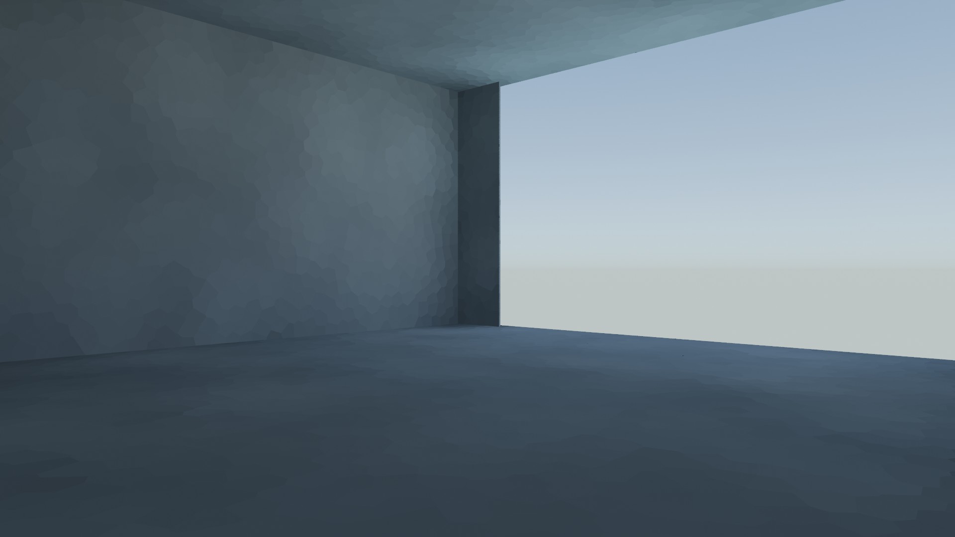

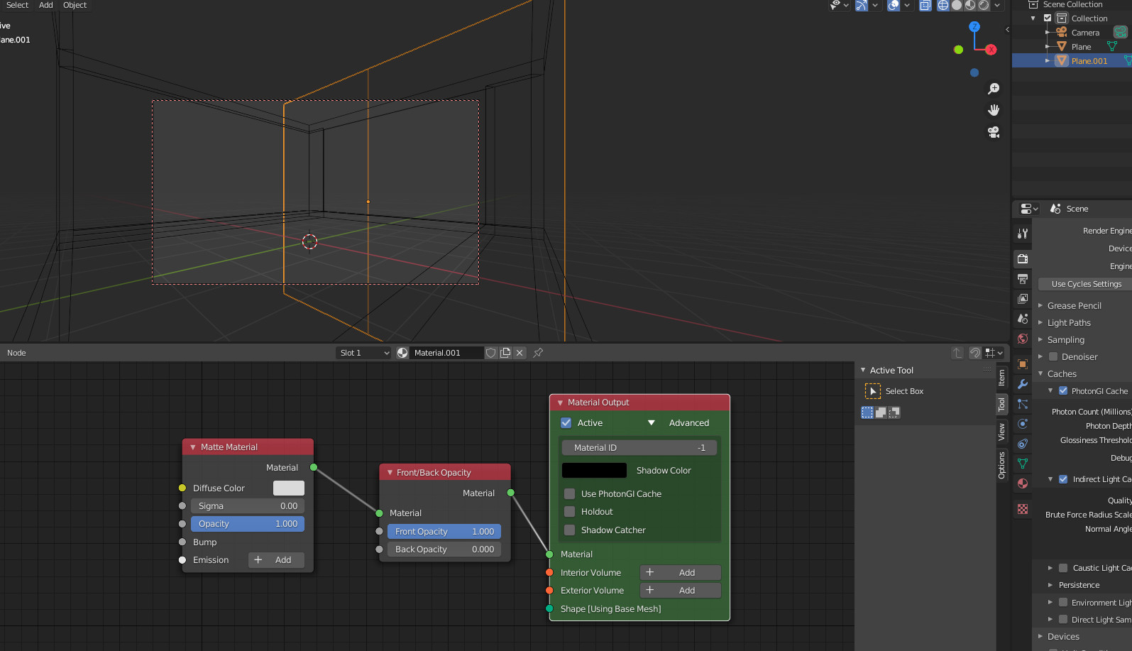

BTW i've tested it and don't have issue while disable PGI on the backplate and set back opacity to zero.so i can use an hdri or sky for lighting
With Bckplate
Without Bckplate

It looks like you used very small backplate. Mine is much bigger than the whole scene (this is sometimes necessary for proper paralax camera movement and reflections, and of course if your scene is big)
Re: emission ruins photon cache
Yes you are right i made bckplate 10X bigger and it kill all.
Another idea is just to compute cache without BCKPLTE and then reuse this precomputed cache for the large bckplte version. Wouldn't that work ?
EDIT
IT work ;)
