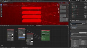

before creating copy of the material for Cube01 Object

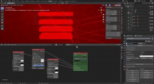

after creating independent copy of the material for Cube01 Object

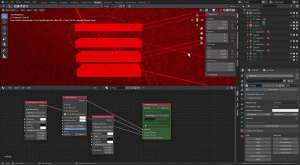

animated gif

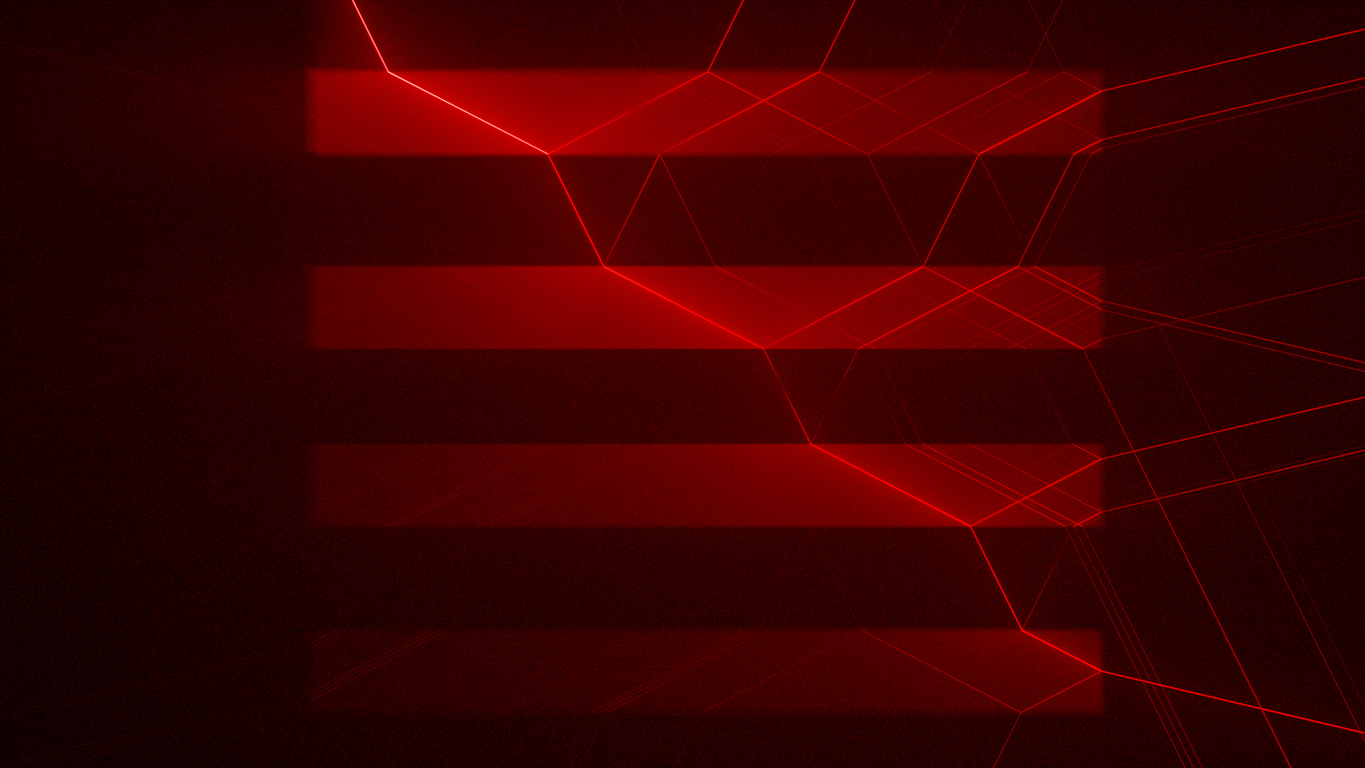

Light Rays Altered After Creating Copy of the Glass Material (BUGS REPORT?)

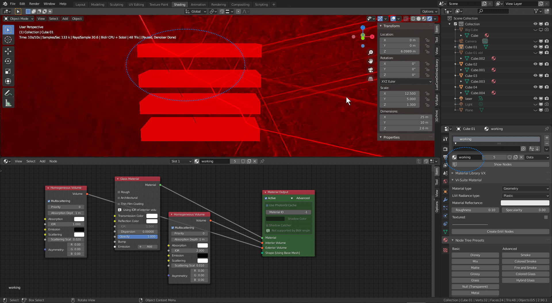

Yes you may try. The Materials are: Working and Working001. Working001 is just a Copy of Working but they seem to behave differently to light.
However I'm not sure if it will be accepted as a bug. After some further thinking I think maybe LuxCore rules for Internal and External Volumes are violated. Maybe only One Shared External Volume is allowed. For Internal Volume maybe no such limits as long Light Rays are exiting back to this Shared External Volume? Hope to hear from the developer.
