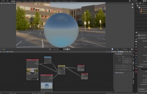

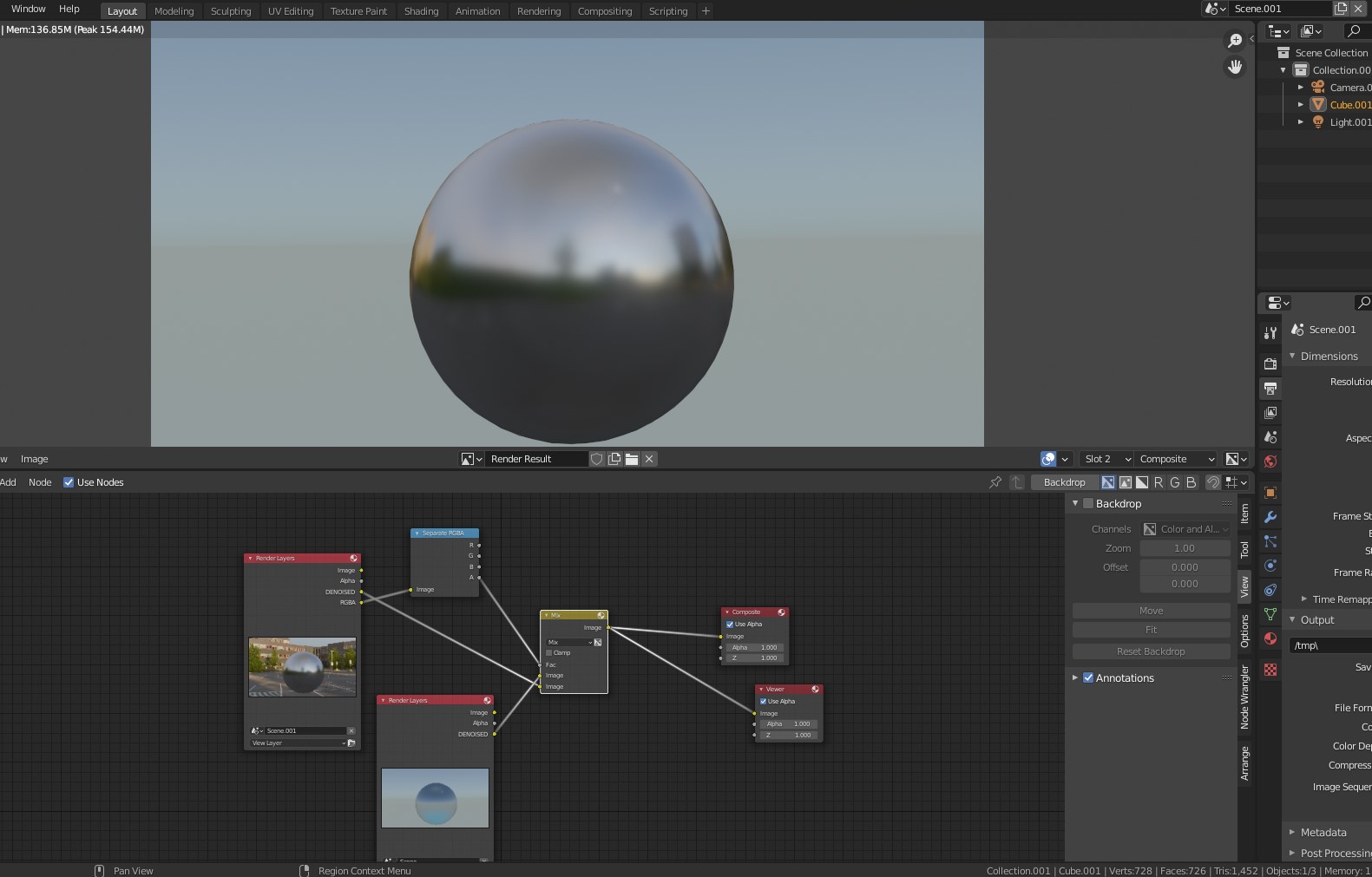

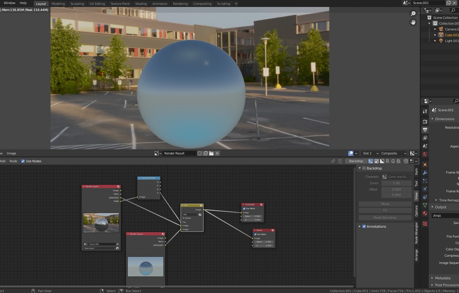

First thing came to my mind is using different scenes to render separate variants of scene and then combine it with compositor. For second scene with standard sky you don't need too much samples - around 20 would be enough.
Also there is a lot of AOV passes you can combine in many ways.

What I would do is map the HDRI on a plane and use it for emission, then place it so its reflection is visible in the pool. You can hide it from the camera if necessary.

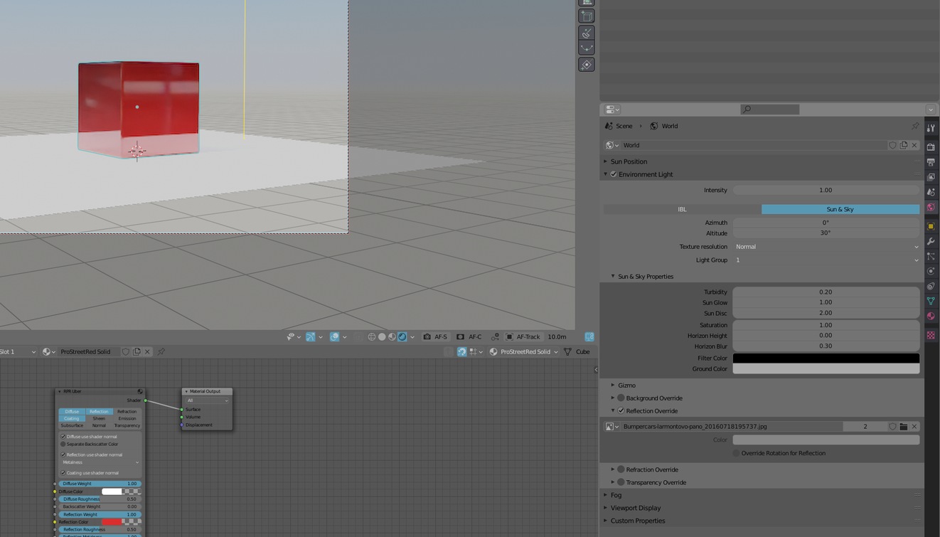

Posts: 821
Re: Physical Sky for lighting + HDRI for reflections, is it possible?
Same principle applies, you still have options to set either PhySky or IBL.
You can check it with RPR for Blender.
https://github.com/GPUOpen-LibrariesAnd ... n/releases
