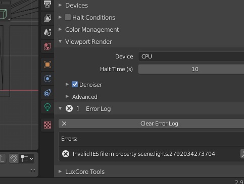

Hello
I uploaded several .IES files and they work but with these from Philips LuxBlender it doesn't render and shows an error.
These Philips files work with other software, is anyone kind enough to check? Thanks

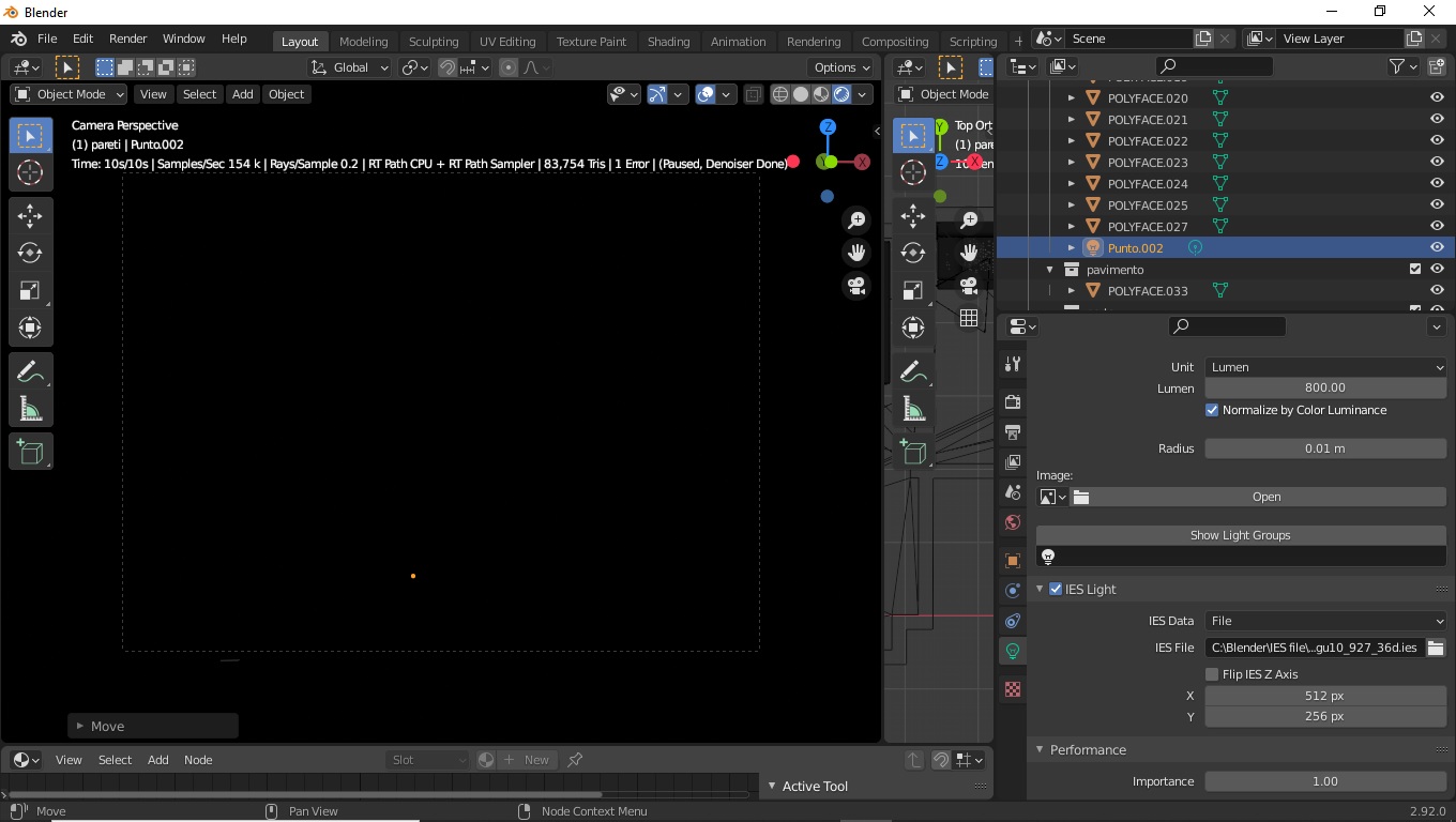

In this post I only write about the render preview and Luxcore 2.5 with Blender 2.92, both commercials have IES files and there is the Philips one.
Turning off the light on the left, Philips freezes but I also noticed that turning this off and turning the other back on again, you have to switch to the wireframe and return to the render preview to see it.

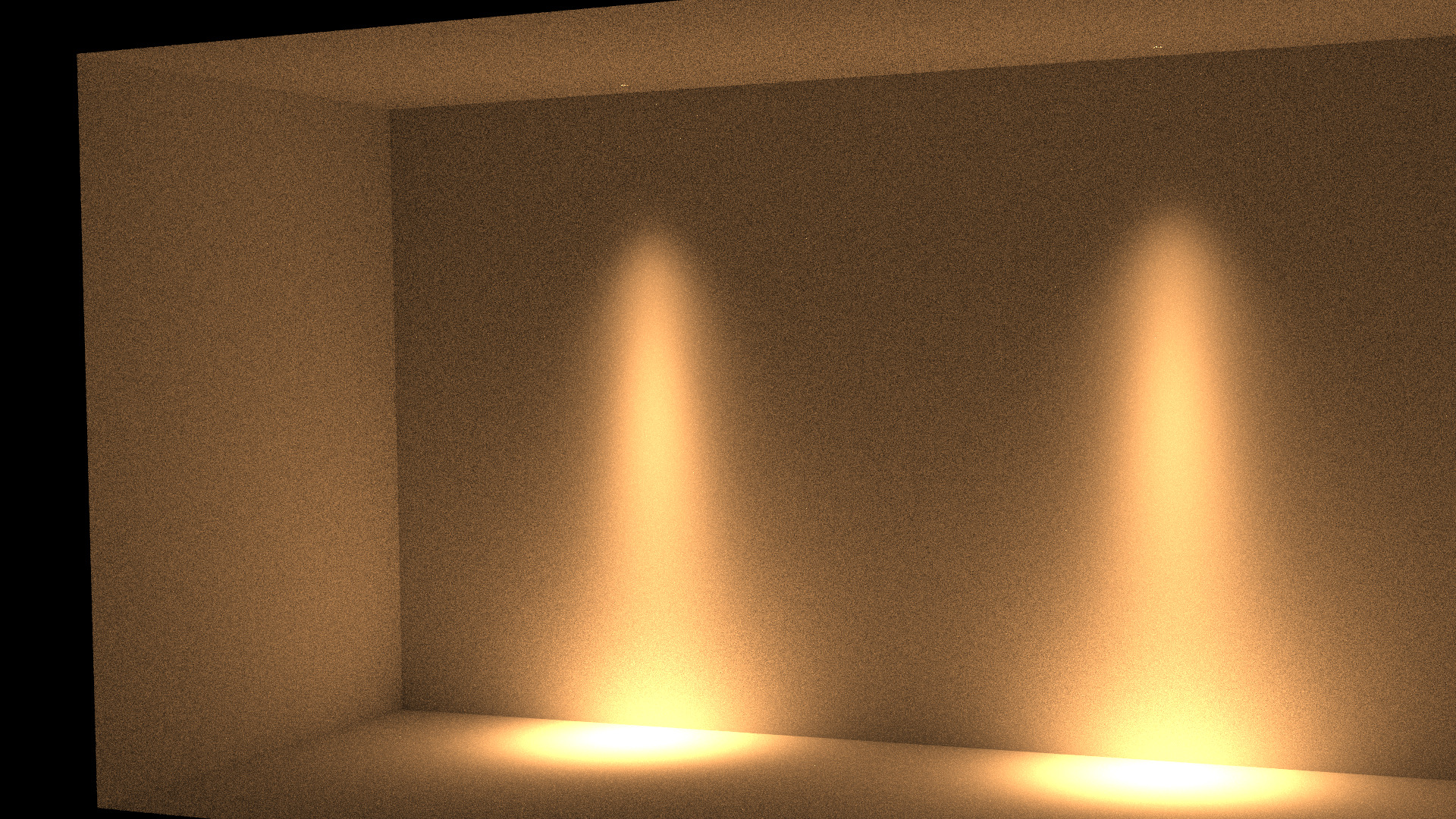

Looks fine... :?

Thanks for trying, I'm glad that it works for you but in the previous screens you can see "error" only on the philips file. Not a big deal because I find other files but in my opinion there is some conflict either in the software or in the configuration I have ... I don't know. Thanks anyway

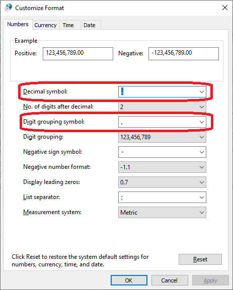

Is your system configured to use "," instead of "." as decimal separator ?
Re: Problem with IES file
Dade wrote: Tue Apr 20, 2021 8:30 am Is your system configured to use "," instead of "." as decimal separator ?
It is likely to be this problem. I should have fixed it in v2.6.

Can you tell me how to change "." "," ?
Is about win10?
Light
XRaf wrote: Tue Apr 20, 2021 11:48 am Can you tell me how to change "." "," ?
Is about win10?
Yes, it is the somewhere in locale/language system settings (I don't know exactly I use Linux). Are you from a European country using "," instead of "." as decimal separator ?
It is in Control Panel --> Region --> Additional settings
Normally the first setting (decimal symbol) is "," in European countries, while the "digit grouping symbol is "."
Try if swapping them fixes your problem.
