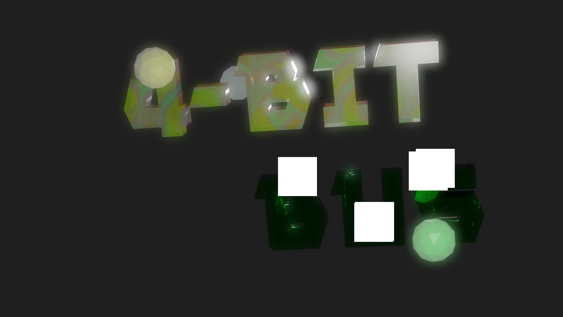

I've used bloom a lot but recently I was creating a scene when it all went wrong. I'm hoping someone can help me tweak settings. Basically I get a large white square in the render. The size of the square is related to the % setting in the boom. I've attached a blender file and an image that shows the problem. I have tried everything I can think of to solve the problem (CPU only, GPU only), tweaked all kinds of settings in lamps, materials, world, render output, camera settings, etc. to try to solve this but I just don't come up with the solution. I have even tried different texture on the "Bus" object to try to solve the problem. If I don't do very many samples (100 or less) I can generally render the animation but with the translucent shader the results aren't good enough for production. This really needs bloom as I don't like the effects glare post prod adds. Anyone with ideas here?

This problem is triggered by some fireflies (i.e. very bright pixels on highlights). The firefly push the box filter of the bloom effect sky high and it ends with the large white boxes you are observing.
I could solve the problem inside the code but it would have some side effect and break some compatibility so I don't want.
However there is a simple workaround: just avoid to have the fireflies by setting variance clamping to something like 100 and it will work fine.

Thank you. I don't think about clamp as much with denoisers I guess because in cycles a little clamp means an image lacking contrast. I'll give it a try.

Next question. Where do I find the "variance clamping" setting. I only see brightness clamping in Render Tab.
Thanks.
mroy
Posts: 18
Joined: Mon Mar 29, 2021 12:48 pm
Re: Bloom Settings
Post by mroy »
Okay, I see that is variance clamp. Got it.
