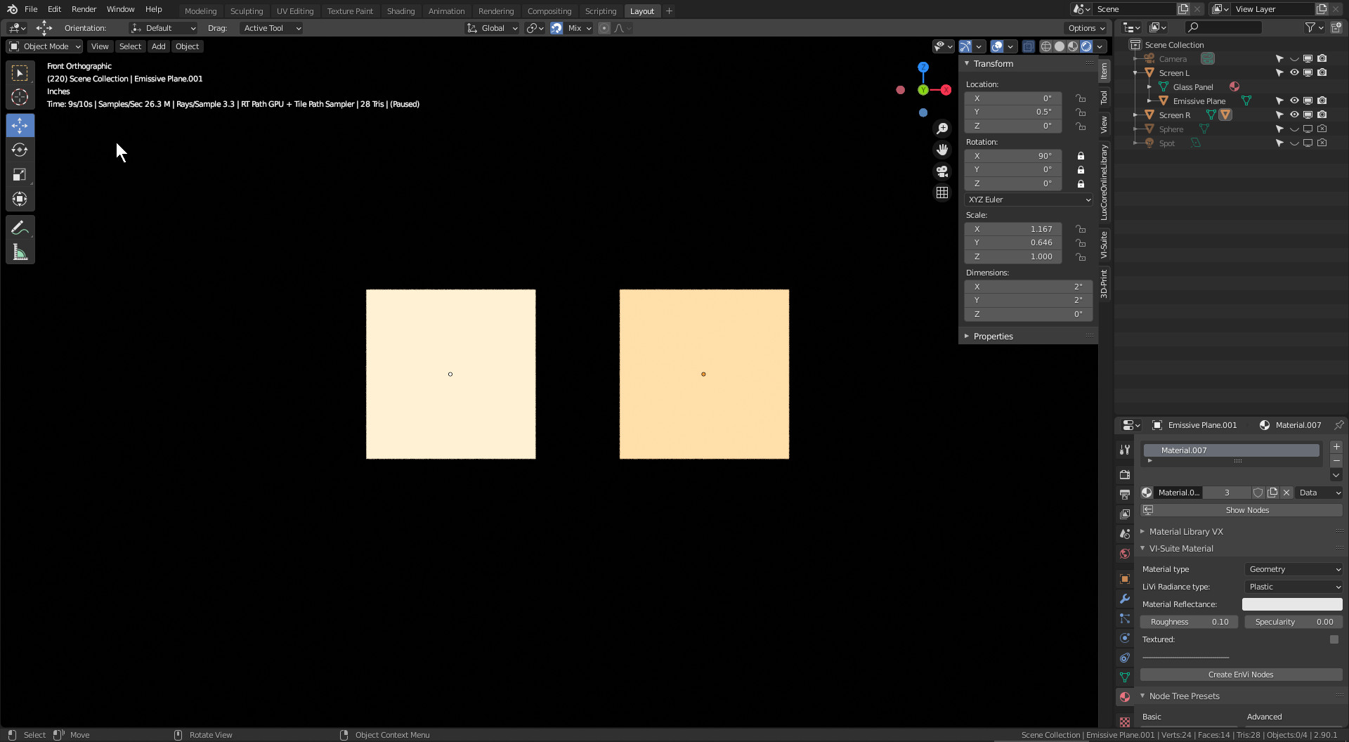

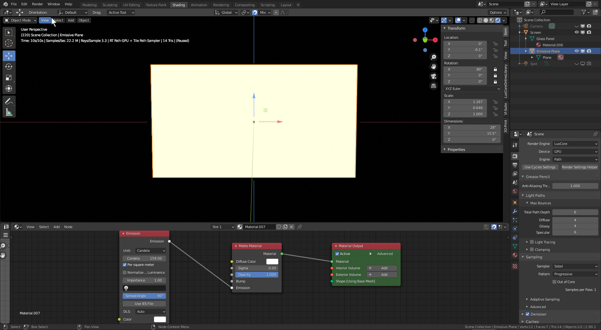

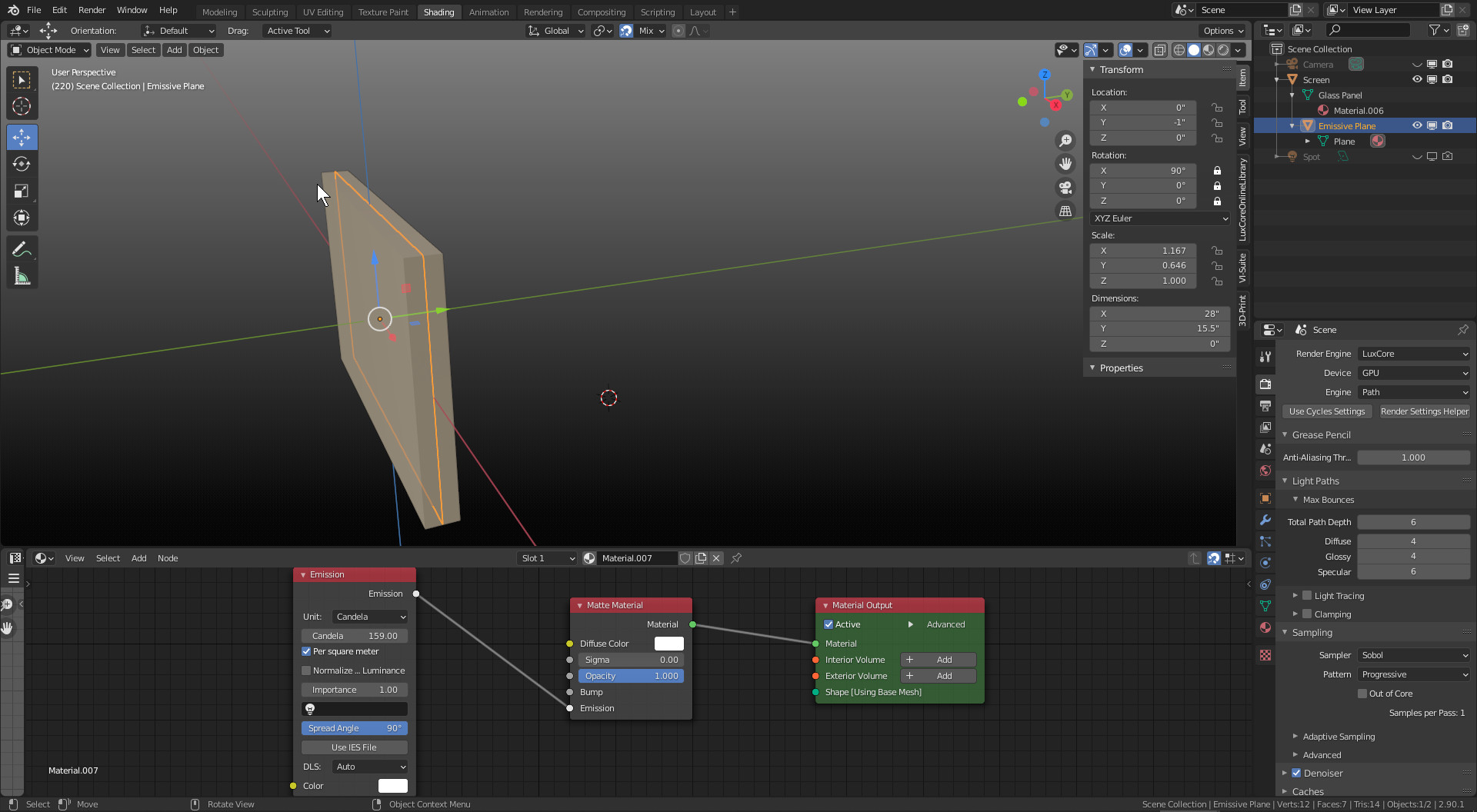

emissive rectangular plane positioned just 0.1" outside and from the back surface of the 2" thick glass cube and viewed frontally through it
emissive rectangular plane moved 0.1 inch inside the back surface of the glass cube and viewed frontally through it
Already eliminated glass light reflections by setting IOR to 1 and same as vacuum as well no other light sources present except the glass transmittance color not equal to 1,1,1. However with transmittance color at 1,1,1 there are no color shift.
What else would cause this strange color shift???

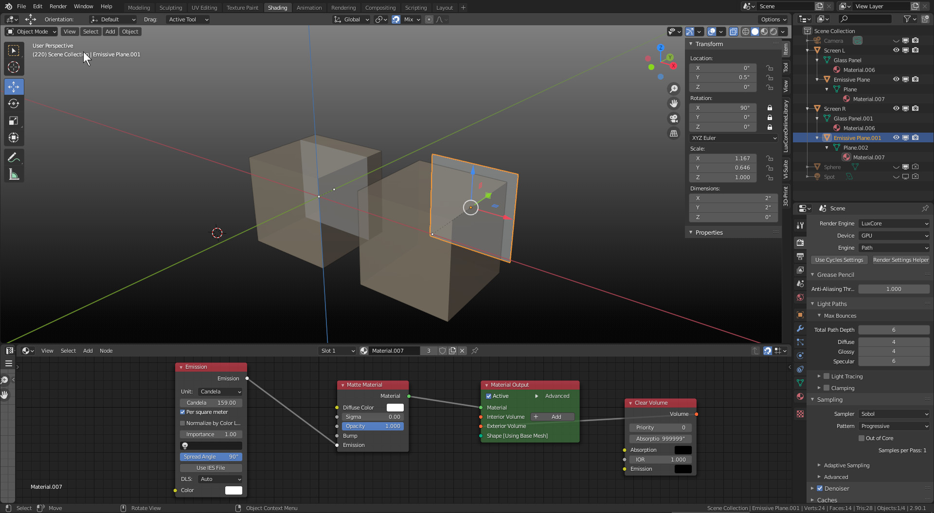

Hi, I tried again but the outcome is still the same.

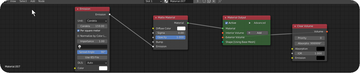

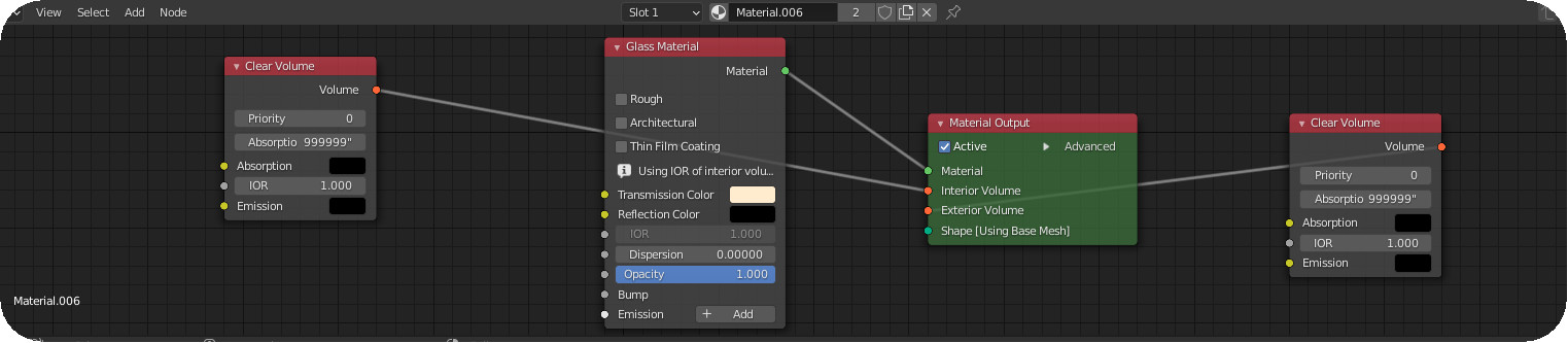

inner volume and outer volume of the glass cube both defined. IORs set to 1

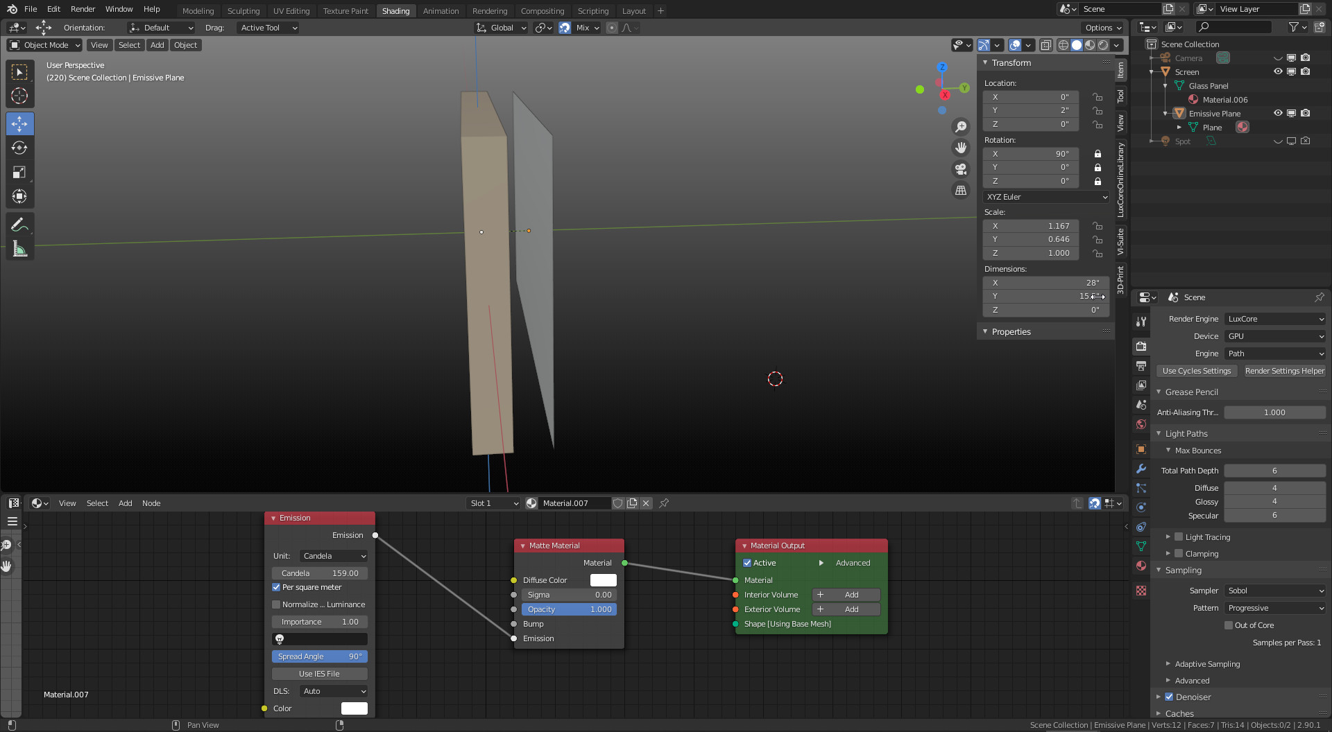

outer volume also of the luminance emission plane defined. IOR set also to 1
With all the materials volume IOR all the same and set at 1 as well Absorption Color 0,0,0 to eliminate loses due to absorption, refractions, reflections and scattering etc. except for the Glass Material Transmission Color 1, 0.829707, 0.614009 but still the right side glass cube looks inexplicably darker?
glass properties 2.blend
(2.23 MiB) Downloaded 250 times
Re: Puzzling Object Color Shift Outside vs Inside the Glass Cube & Seen Thru It Even When IOR at 1 and Reflection at 0,0

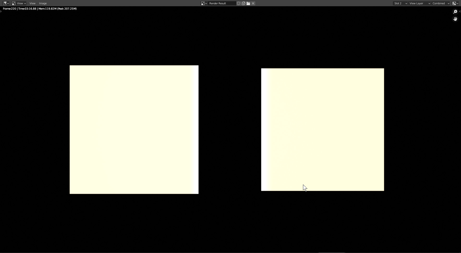

You are setting your glass transmission to "1 0.829707 0.614009", so it is applied 2 times in one case (i.e. entering/exiting the glass) and only one (i.e. only entering the glass) on the other. If you set the value to "1 1 1" , you will get the same rendering in both cases.
Materials are a "surface" attribute while volumes are about the "space" inside an object. I guess you want to use volume transmission parameter instead of surface transmission.

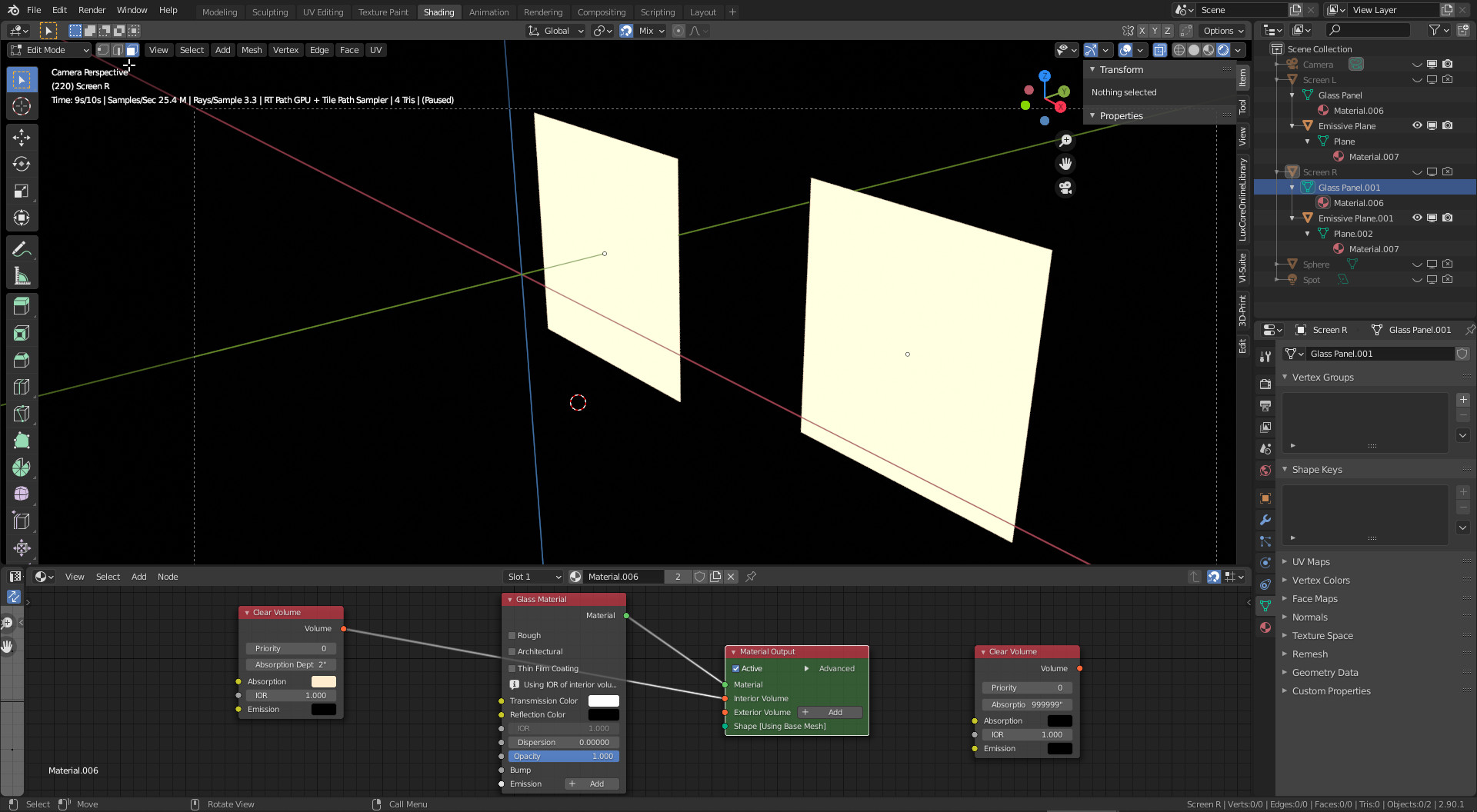

Updates:

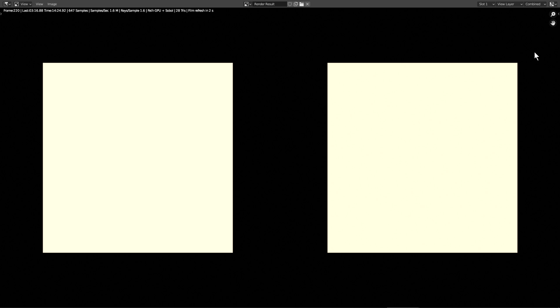

I finally got the expected results by setting the Glass Internal Volume Absorption Color to the Desired Color while the Absorption Depth to the Thickness of the Glass Cube while the Glass Material Transmission Color now to 1,1,1 instead. Material Transmission Color doesn't account for the material thickness and was twice filtered in case when the emissive plane is at the back side of the glass cube.
However I got another issue. The color looks only perfectly even when viewed orthographically .

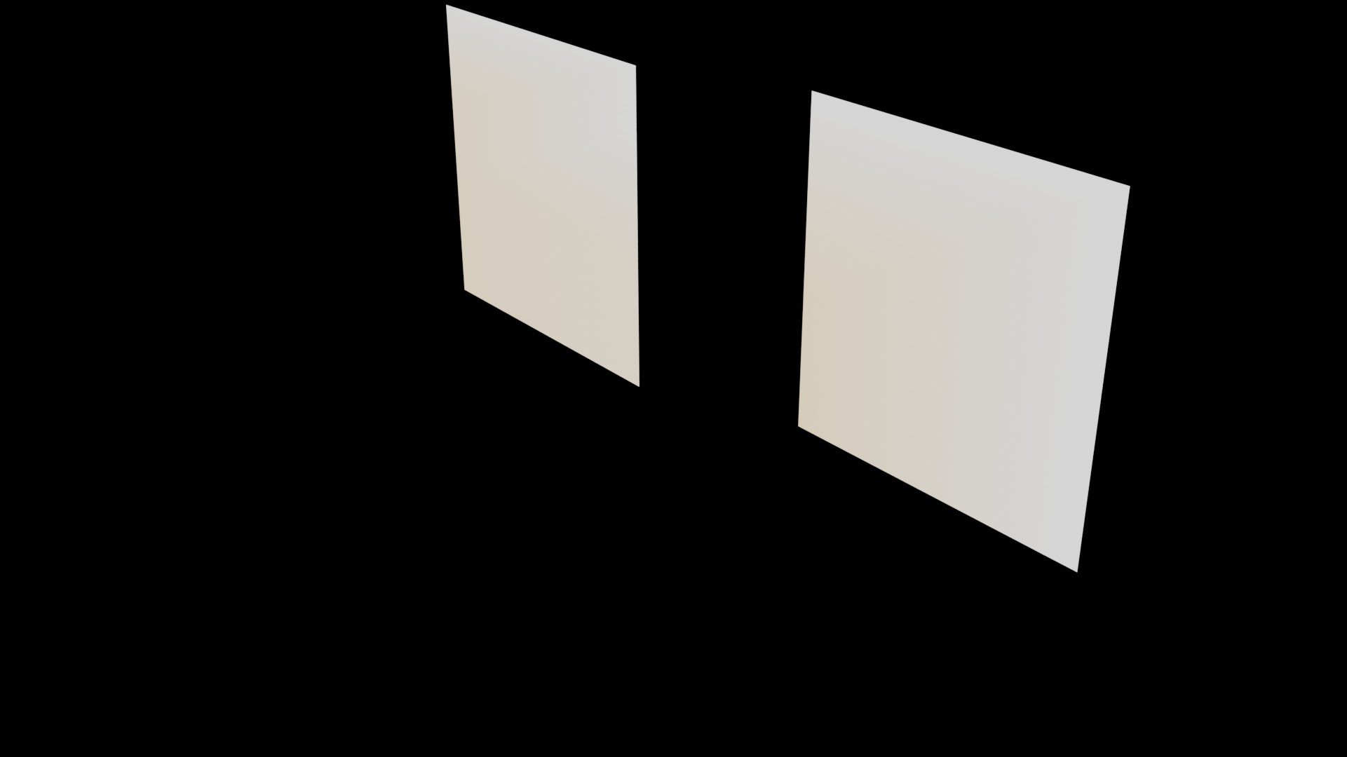

orthographic and front
perspective and front
perspective and angled
Where did the white come from? Why the color changes seems to be so abrupt?

Jan wrote: Mon Mar 22, 2021 11:28 am However I got another issue. The color looks only perfectly even when viewed orthographically .
It is correct :?: With orthographic camera, the rays will travel inside the cube for the same distance (i.e. they are all parallels) while, with perspective camera, the rays will travel inside for different distances (i.e. they irradiate from the camera origin, in different directions), more they travel and more they are absorbed.

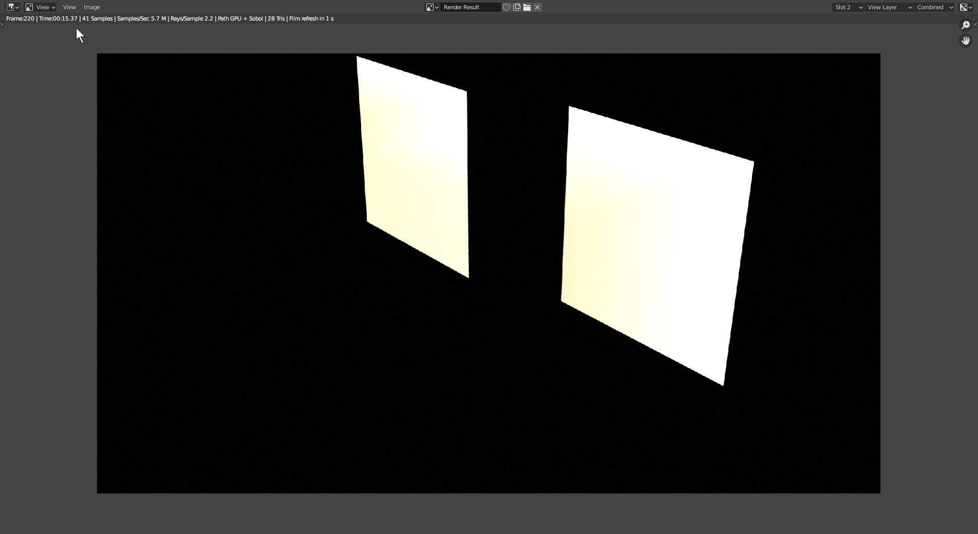

Thanks and agreed! Additionally it must be the different Absorption Depth that affects the Luminances of the surface at different angles from the camera origin and the further the angle from the camera origin to the surface area portion the darker it should look for perspective projection.
This is not the case for Lambertian emission surfaces without the glass panel between the camera.
It looks more natural now with Filmic View Transform under Color Management :D
