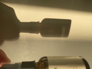

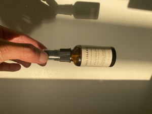

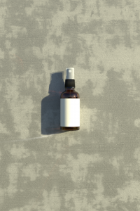

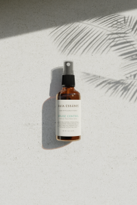

If anyone can help me get the nodes correctly setup to achieve colored glass and also help me understand rendering a high enough quality image. The grey concrete is LuxCore and the white concrete is Cycles. The other images are my IRL references.

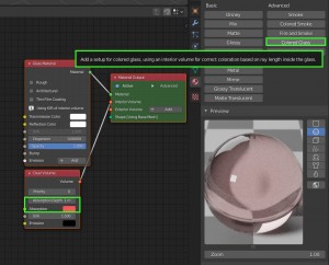

Like this :
Just play with absorption deph and color setting to have the desired effect.
