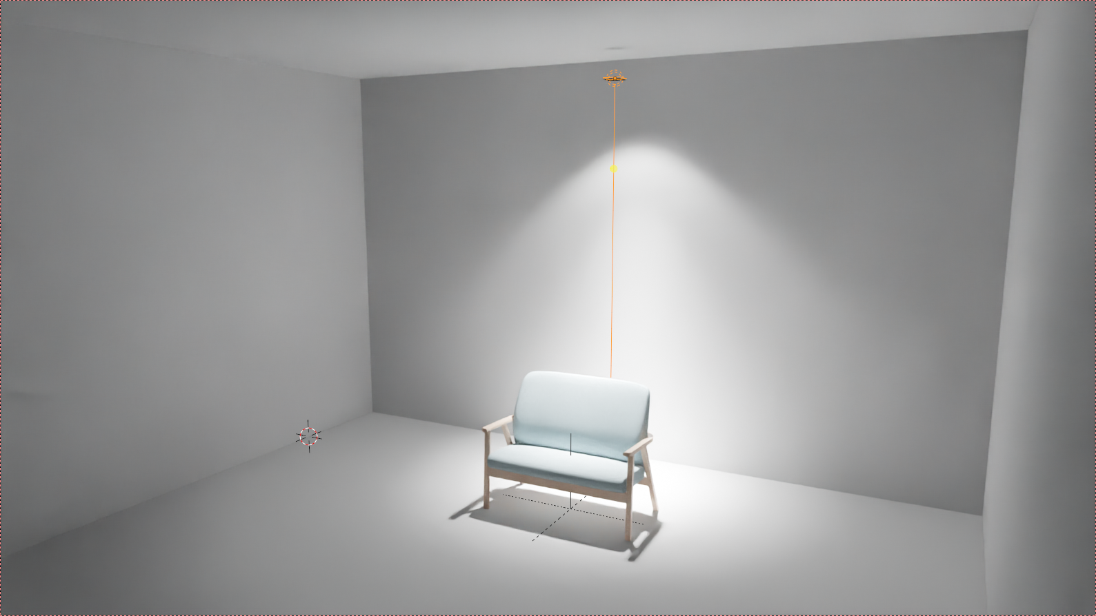

I have a scene similar to the photo below and I was wondering about the way to achieve this lighting setup. I am interested in the lighting above the logo space in particular, but if you have any tips on how to make the lighting of this entire scene, that will obviously be very beneficial to me.

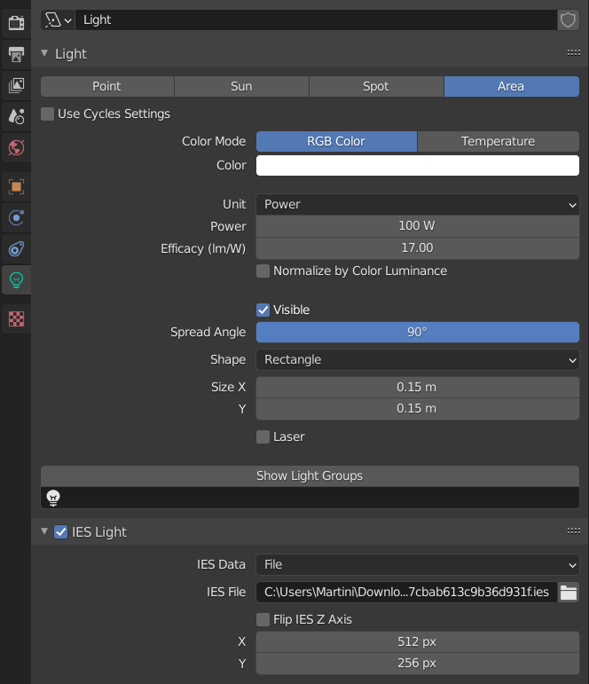

The easiest way is probably to use an IES light. For example, at this site, you can find literally thousands from some different real-world manufacturers.
You just need to browse the library and look for one that suits your needs.
