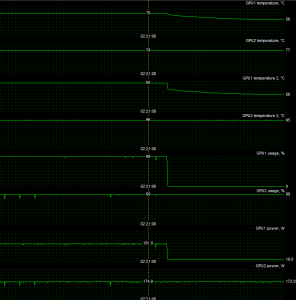

I have attached a screenshot of MSI Afterburner with the 2xGPUs setup. As you can see there the GPU1 drops usage, power and temp and GPU2 is running normally.
