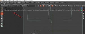

Hello friends, following Sharlybg's tips, I made some adjustments, but I went to fix the drops and now I get this error from MatrixInvert and it doesn't render anything. What can I do to fix it?
Re: Help with studio setup and packshot
JulianoLisboa wrote: Mon Jan 25, 2021 4:47 pm Hello friends, following Sharlybg's tips, I made some adjustments, but I went to fix the drops and now I get this error from MatrixInvert and it doesn't render anything. What can I do to fix it?
"Matrix invert" is an error you may get when the "Up" direction (aka vector) and the looking direction are exactly the same, there may be something wrong in the camera you are using.

I deleted the camera, created another one and the same error happens.
JulianoLisboa wrote: Mon Jan 25, 2021 5:05 pm I deleted the camera, created another one and the same error happens.
It may be also the matrix transformation of some object set to some odd value (like a 0.0, 0.0, 0.0 scale).

Can you post the scene giving the error ?

Here's a quickie...
There were few more issues in the scene. Study changes by comparing ;)
And I'd still want to resolve couple of things, but got other priorities.
