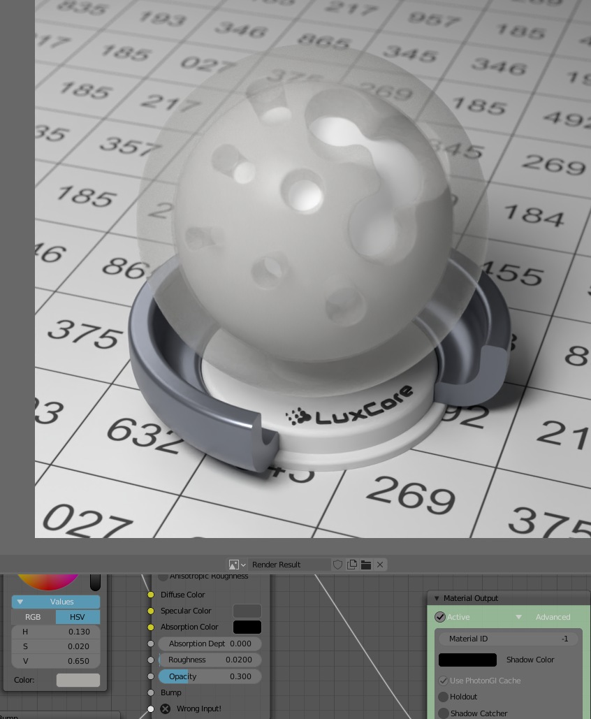

The adventure continues. I can't handle the question.
If there is Band in the material at the Bump input, then various artifacts occur. For example, when rendering with tiles:
https://prnt.sc/w2niv7
Here is an example artifact file: https://dropmefiles.com/urSRR
I have tried all drivers on Windows and Linux.
Could it be my graphics card? Or does this happen on all AMD video cards?
Re: system hangs when GPU rendering material
Dez! wrote: Mon Dec 14, 2020 6:59 pm Could it be my graphics card? Or does this happen on all AMD video cards?
Yes, it is an AMD-only problem: https://github.com/LuxCoreRender/BlendL ... issues/593
Dez!
Posts: 369
Location: Ekaterinburg
Post by Dez! »
Thank you for your reply.
I reconfigured the materials and everything works great now.
