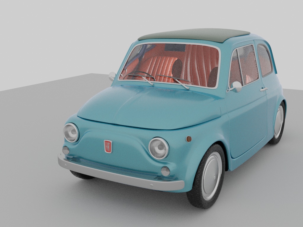

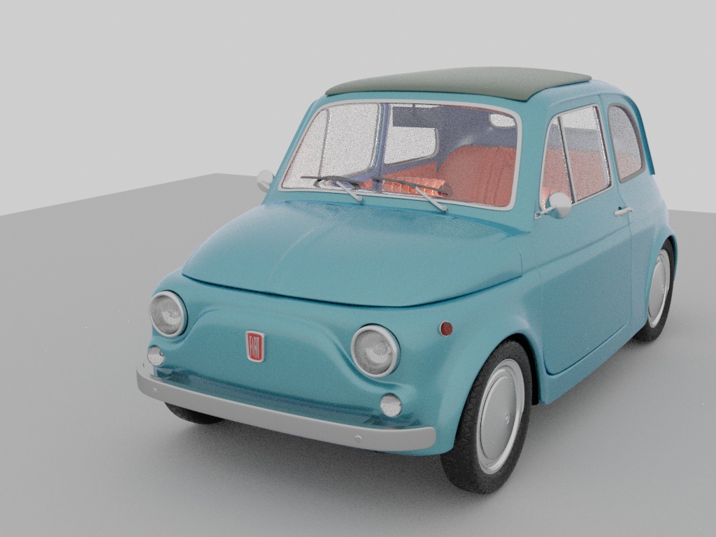

In the last blendluxcore daily the glass looks deformed like the mesh has no thickness, in the released 2.5 beta 1 on github https://github.com/LuxCoreRender/BlendL ... _v2.5beta1 it looks ok.
Here is the test file:
500 glass bug.blend
(4.71 MiB) Downloaded 319 times
latest version
original 2.5 beta 1

I should have fixed this regression due to a recent commit.

Thanks Dade, i checked the latest version and the problem is fixed.
